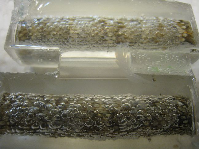

Where oh where did I go wrong?
Snake skin is dry, had it in the shop for awhile now, its been glued to the tubes at least a month or two.
Cast tonight and not sure what happened after that.
Put into pressure pot - cast at about 17lbs so I wouldnt force alumilite into the tubes.
Blanks was tacky when taken out of the pot. At that time I only had one "blowout" bubble on one end where a little air must have snuck out from the tube. After they were fully dry, I saw all these bubbles.
It was under pressure at least 20 + minutes
Alumilite Crystal Clear
Thanks Jason
Jason, I gave up using Crystal Clear for skins, it seems to be a waste of time, try using water clear for it.
If you are going to try it agin, leave it under pressure for a couple of hours.
I had a scorpion fart once in PR. instead of bubbles, you get a nasty crack... that smells funny:eek:
I know bruce119 made some snakeskin blanks with Alumilite. He sold them here and I bought a few from him. There weren't any bubbles in those, so maybe shoot him a PM. I don't think Crystal Clear was available then, so it's likely he used Water Clear.

I was thinking that at first too though but whats the max I could do though without forcing the alumilite into the tube?
Thanks!
I guess how much pressure you use is somewhat dependent on how you are plugging your tubes. My thought, when I finally get around to casting blanks with the tubes, would be to turn wooden plugs that taper (picture the types of rubber plugs you used on test tubes in science class). The increase in pressure should press on the plug but not press it in completely or allow leaks.

Jason, while they argue the laws of physics, try a few things that may actually help you. First, make sure the scales are removed before casting, second, rub a little alumilite onto the skin with your finger or a stick to get it into all the little nooks, third, plug the tube with a dowel or rubber plugs, fourth, leave it under a higher pressure overnight.
Thanks lol
Will give it a try :)
Would putting a good coat of CA over it help before doing the alumilite? I imagine it would need to sit a day to degas?
