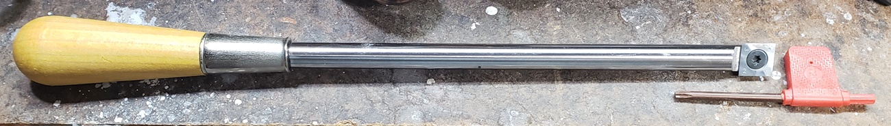

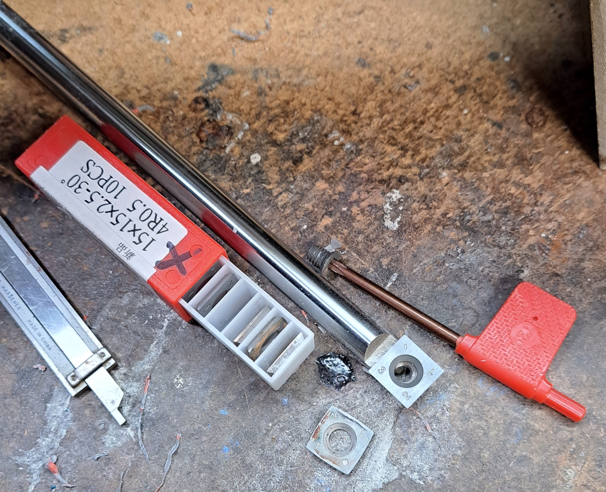

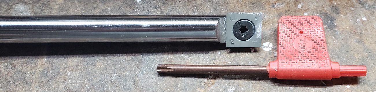

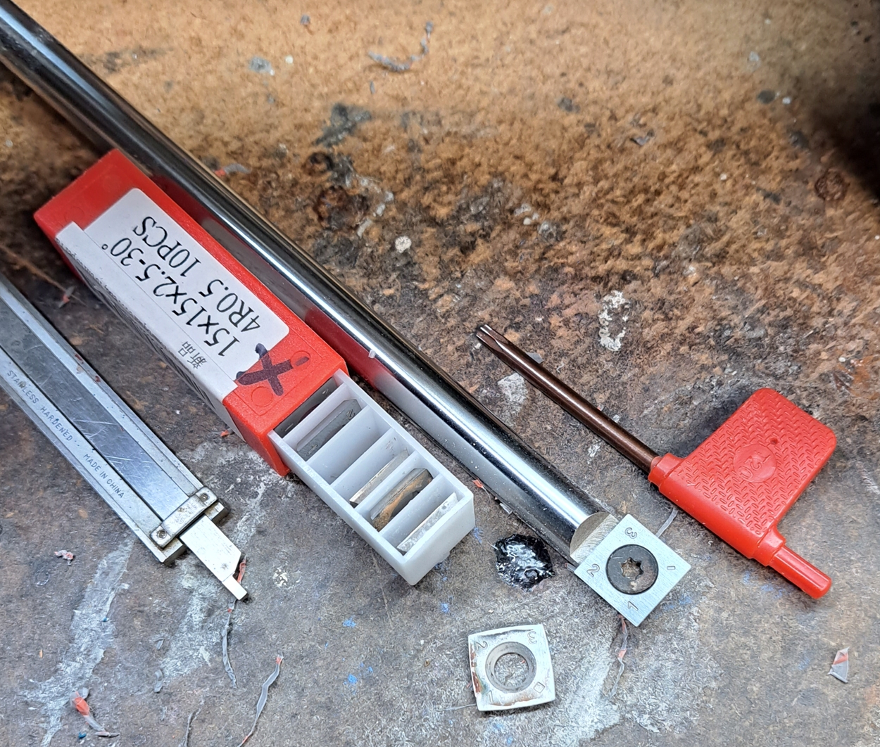

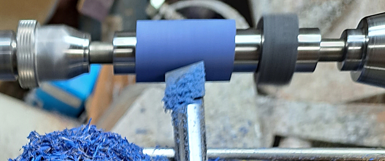

John; A contrary view is I use a skew for softer synthetics, but I have a Carbide tool (bottom one) presented below center for harder or chippy synthetics. For the skew make a shearing cut, don't scrap. The bottom carbide bit is what I use for the hardest of the synthetic TruStones and the like. In either case you should get endless ribbons of material off the tool. You should not have shards and have pits in the pen blank,

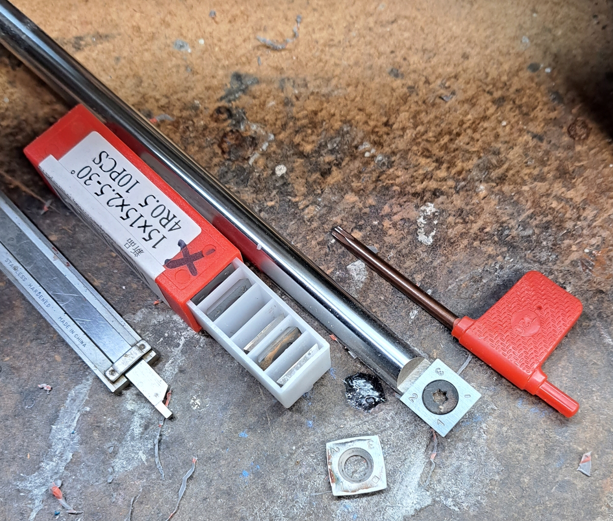

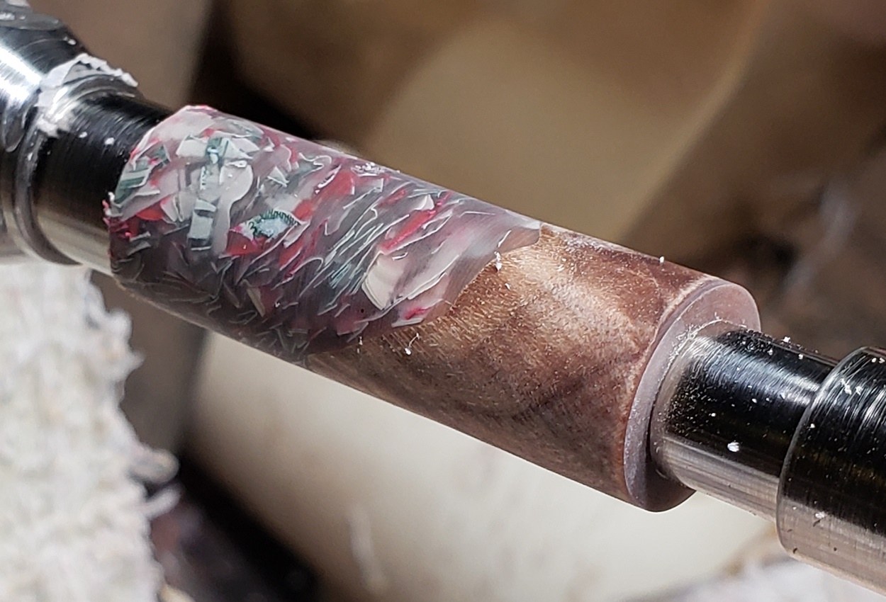

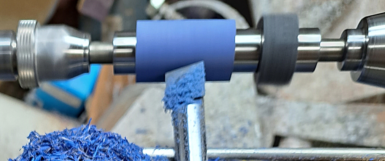

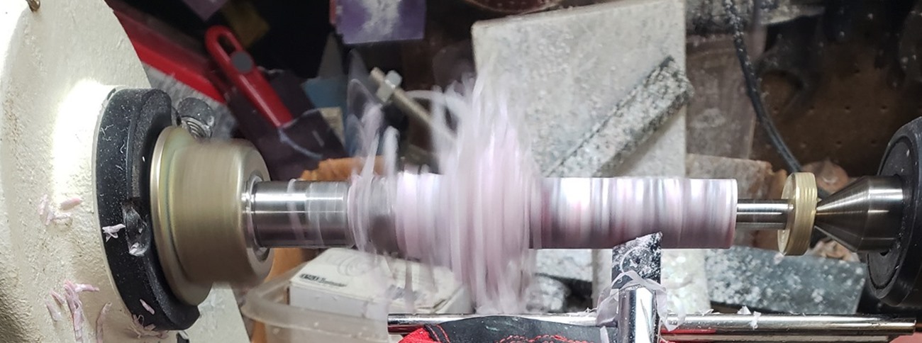

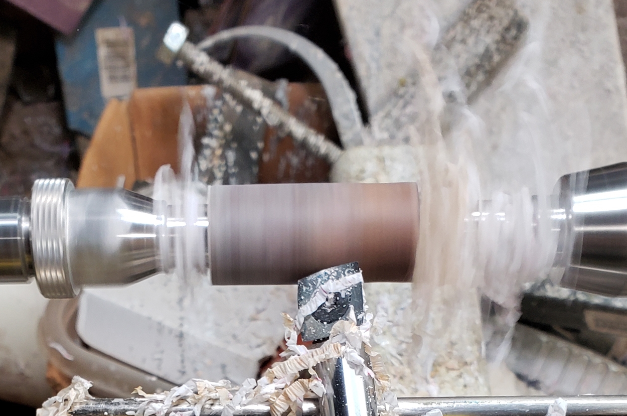

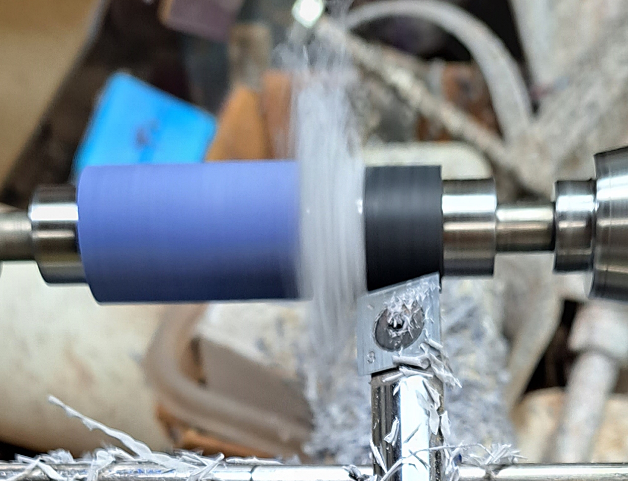

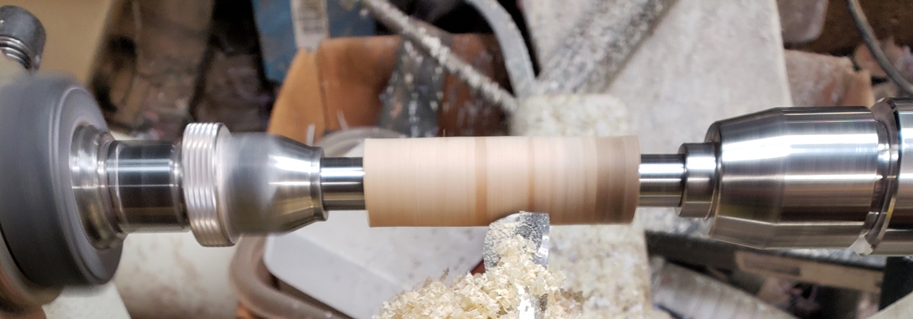

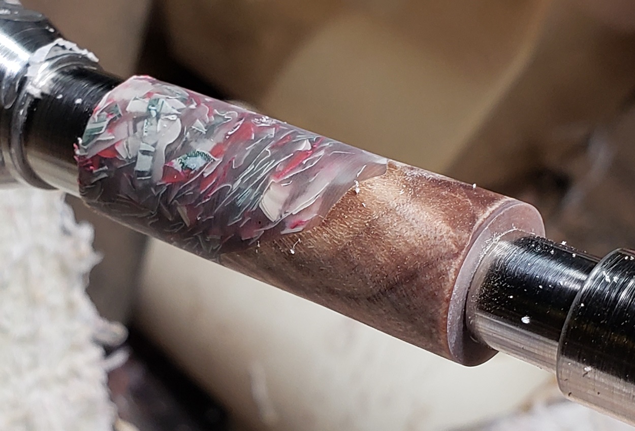

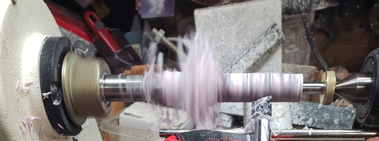

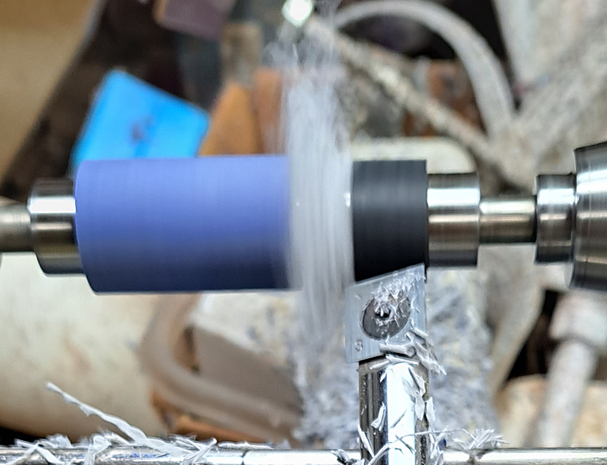

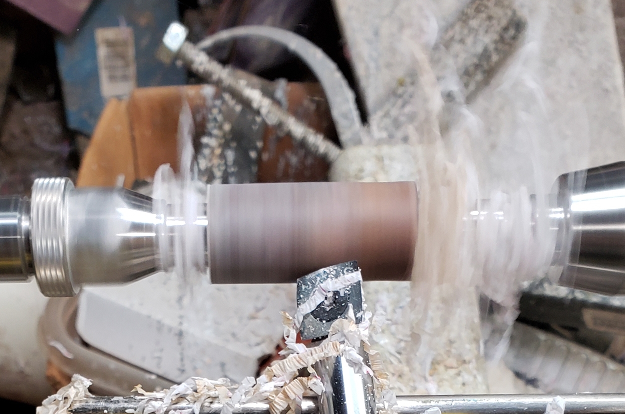

I use carbide with a shearing cut now on everything. Wood, acrylic, hybrid, and even inlace acrylester. I'm no longer afraid of turning brittle acrylics.
Thanks to Jim's prior recommendations for sheer cutting like this, this is generally my go-to as well. There are times when I'll use a negative rake cutter flat to the blank, as for some things that still gives me a cleaner finish, but sheer cutting is an extremely valuable skill and will work on pretty much any material.

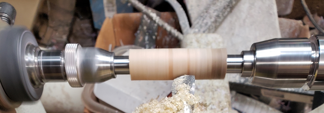

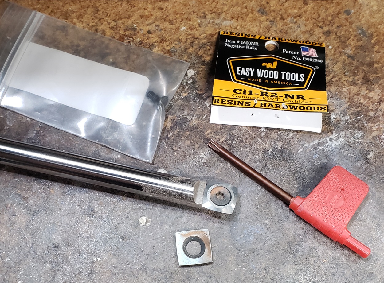

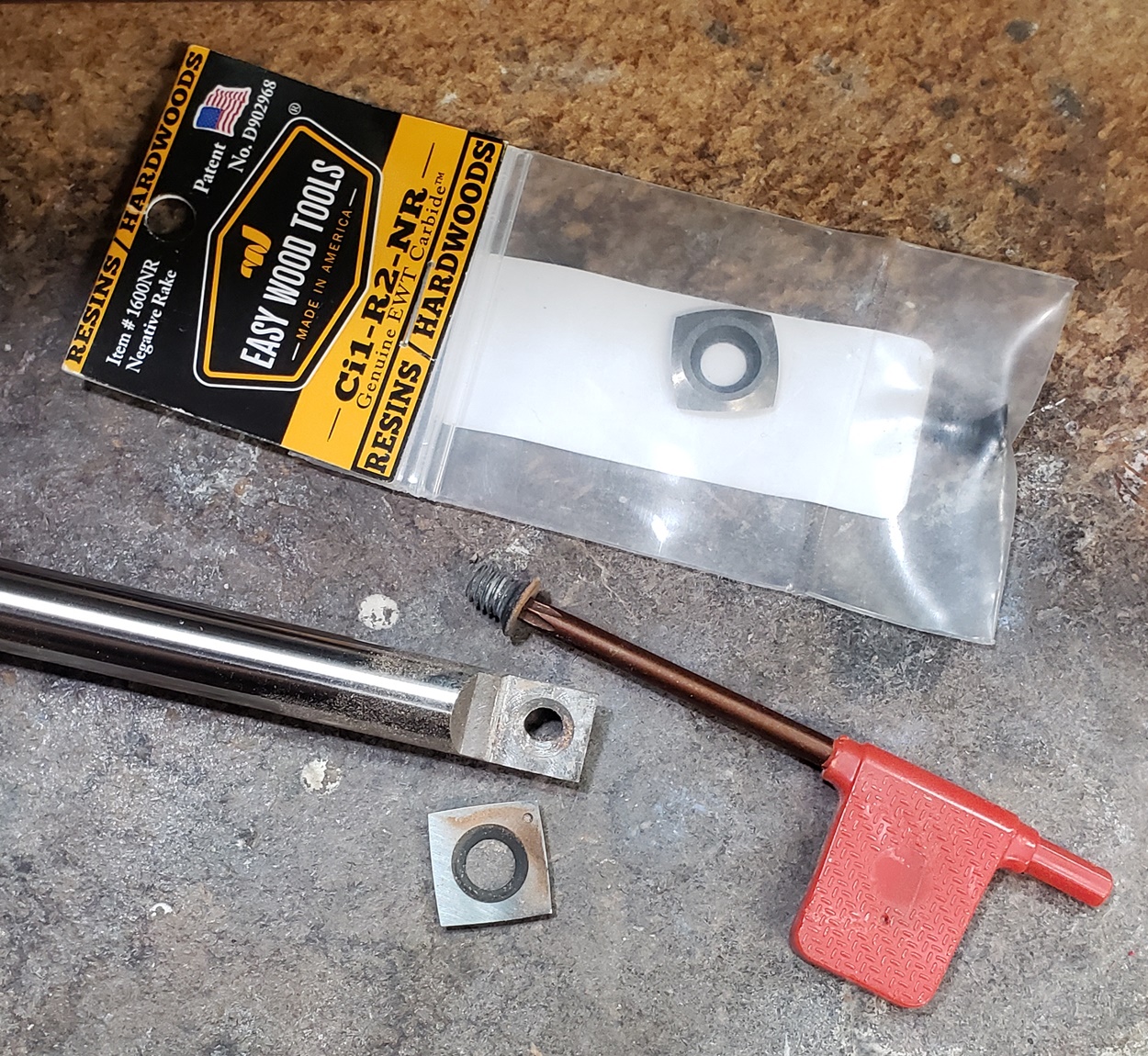

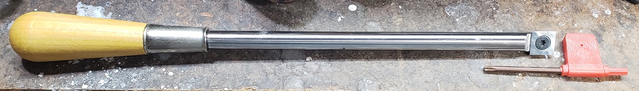

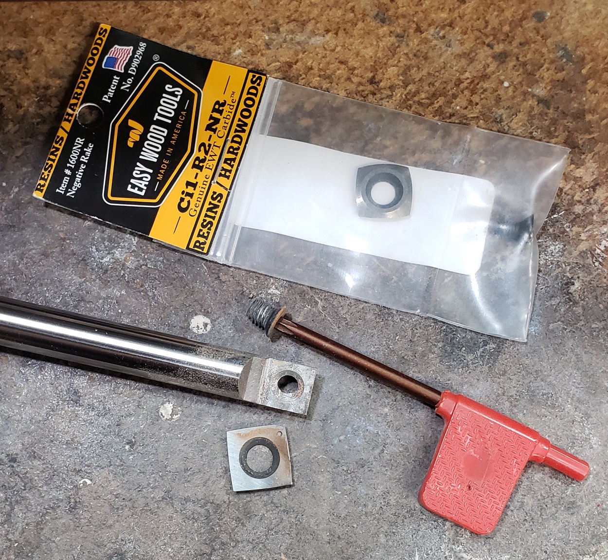

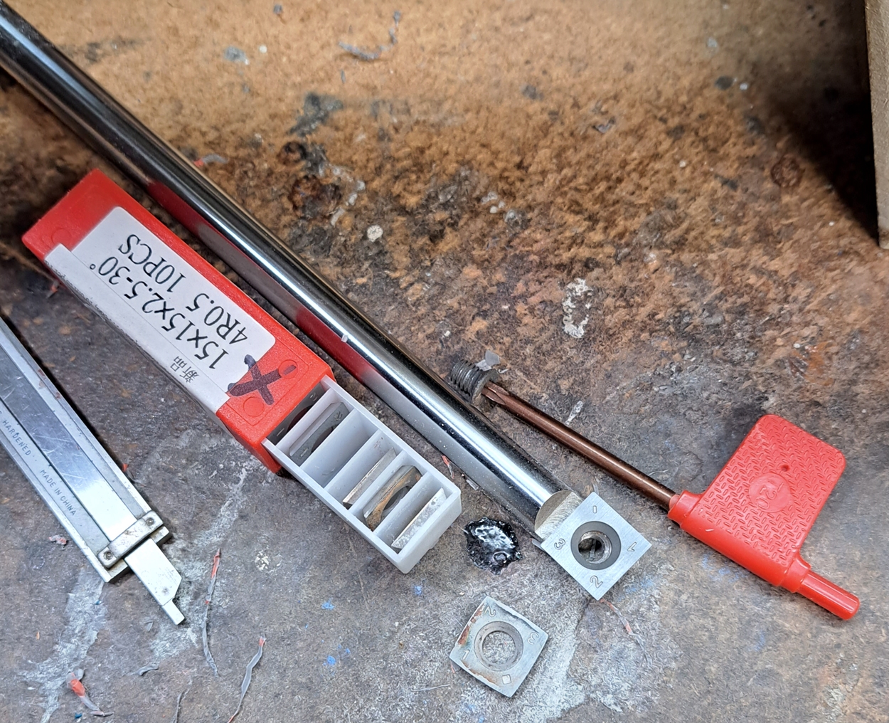

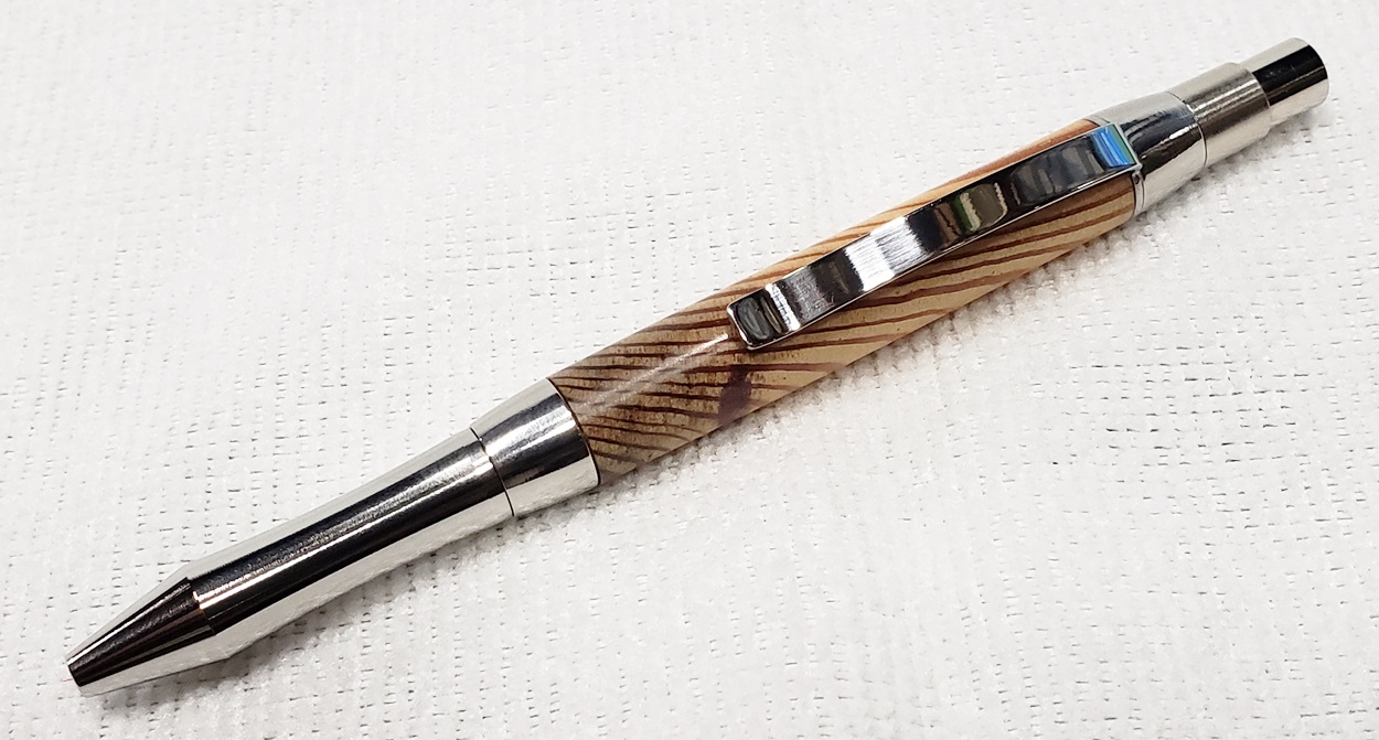

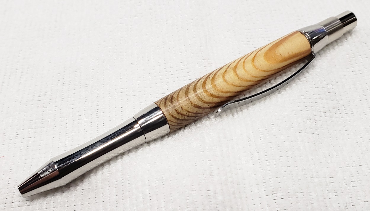

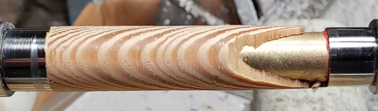

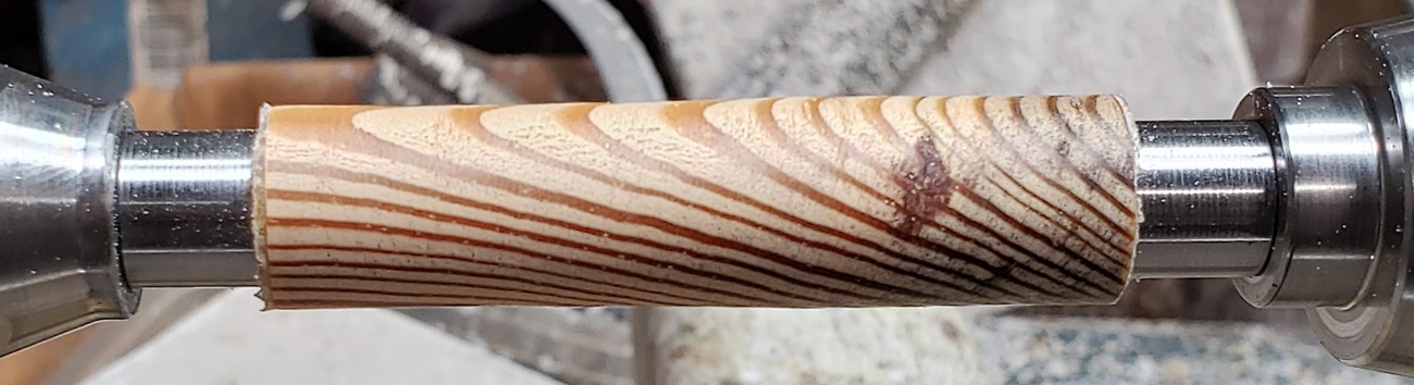

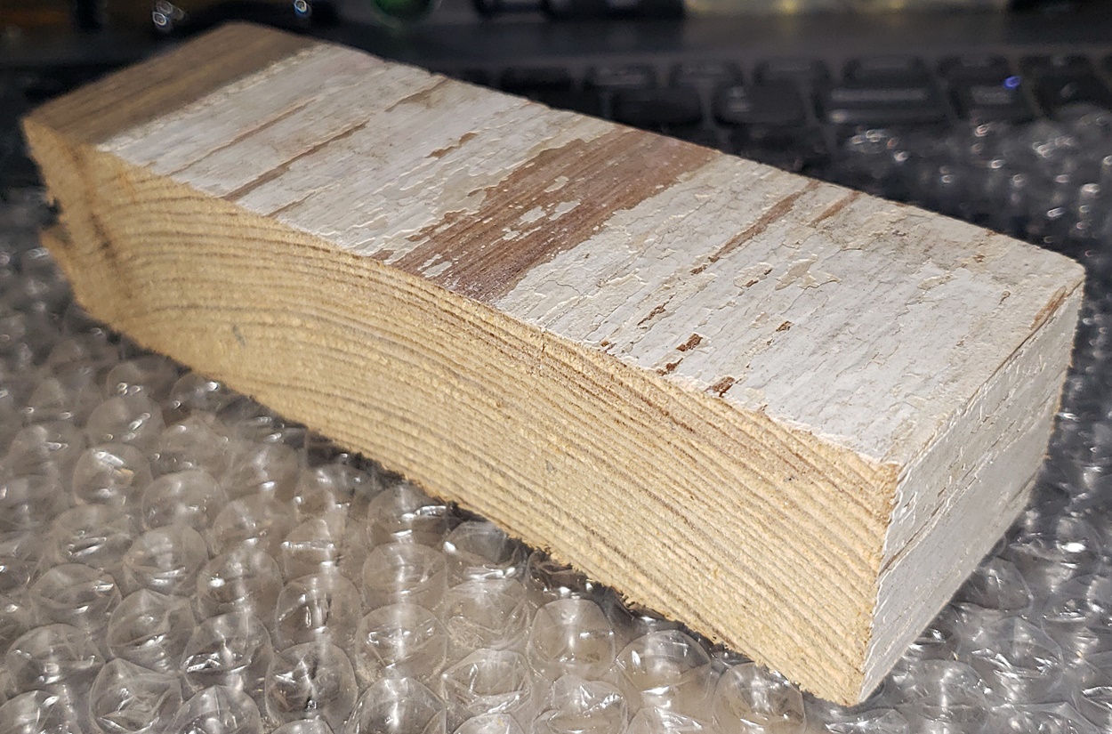

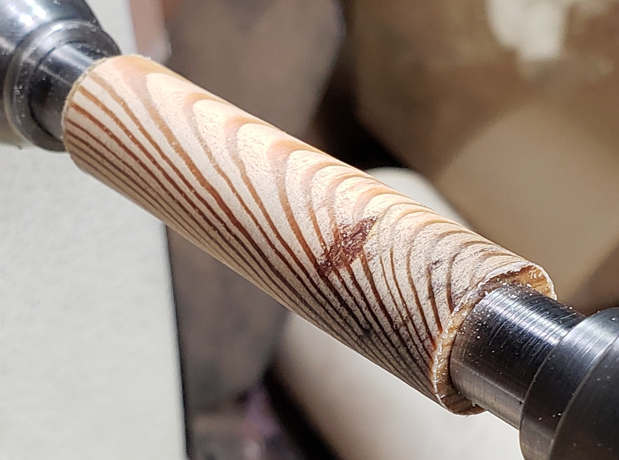

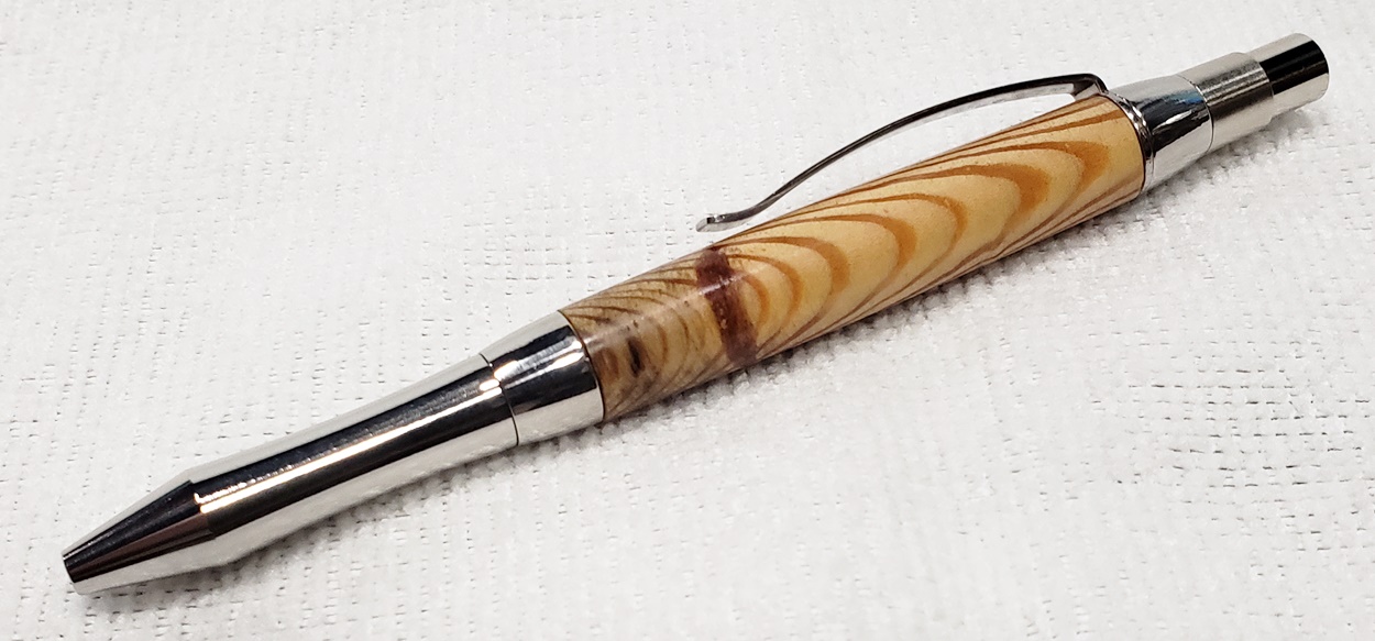

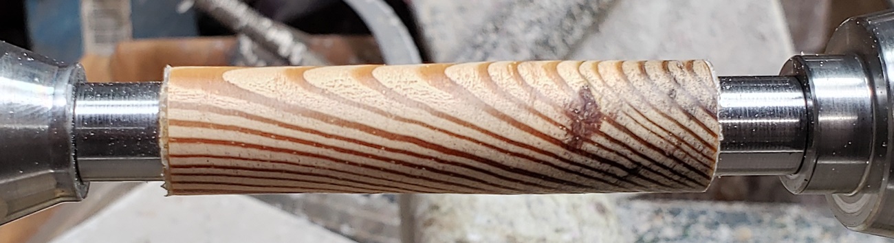

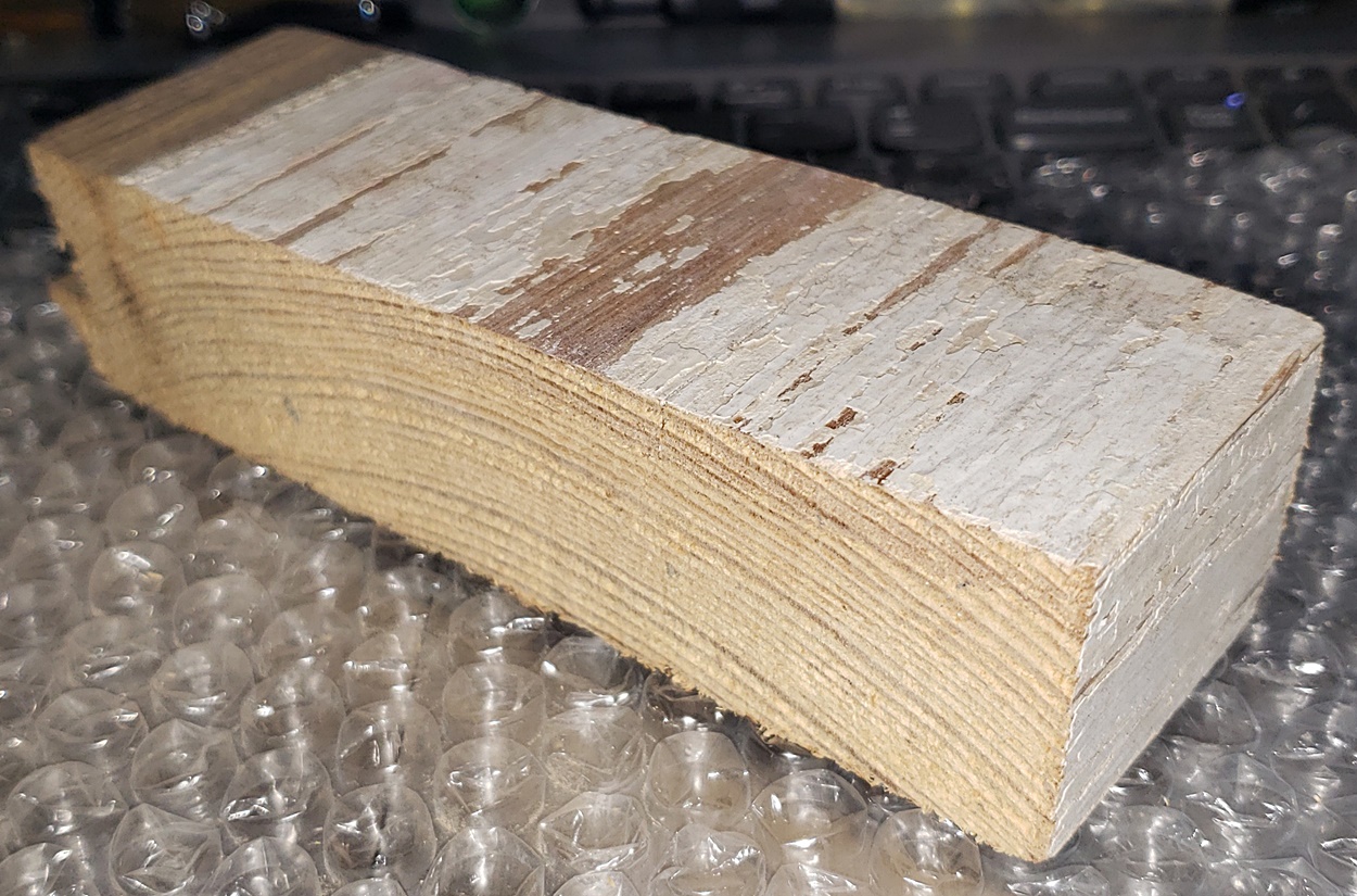

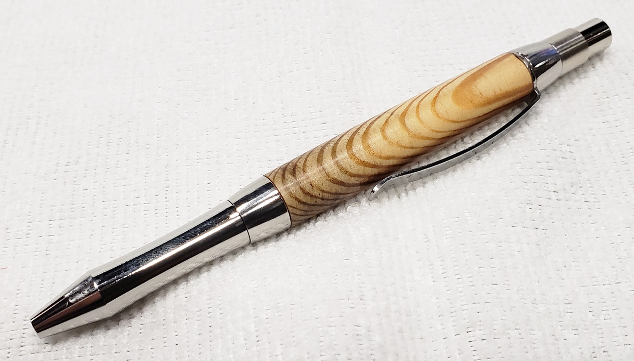

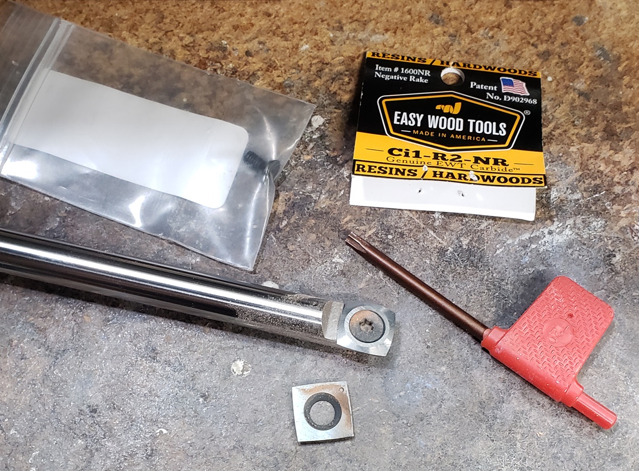

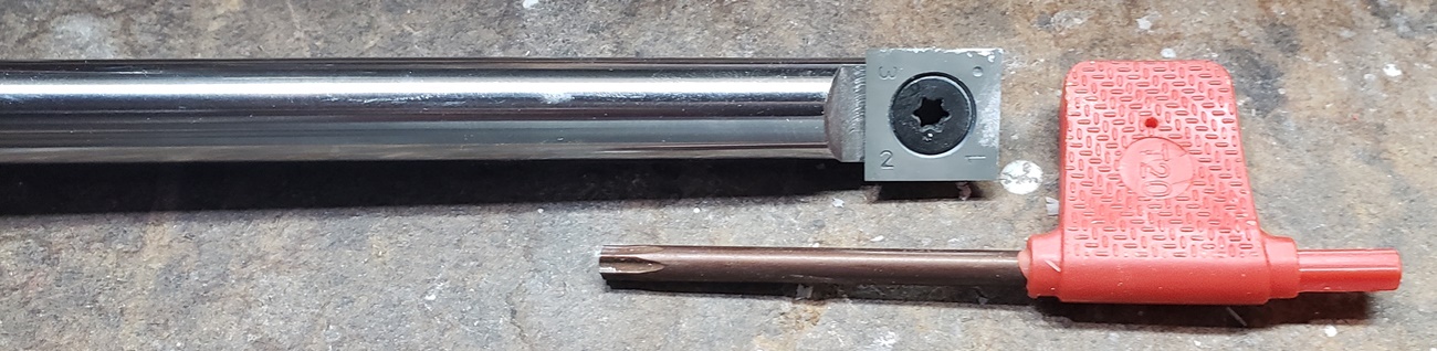

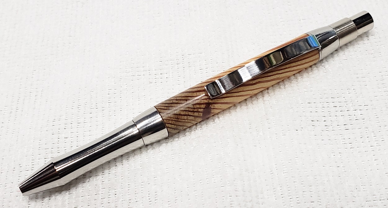

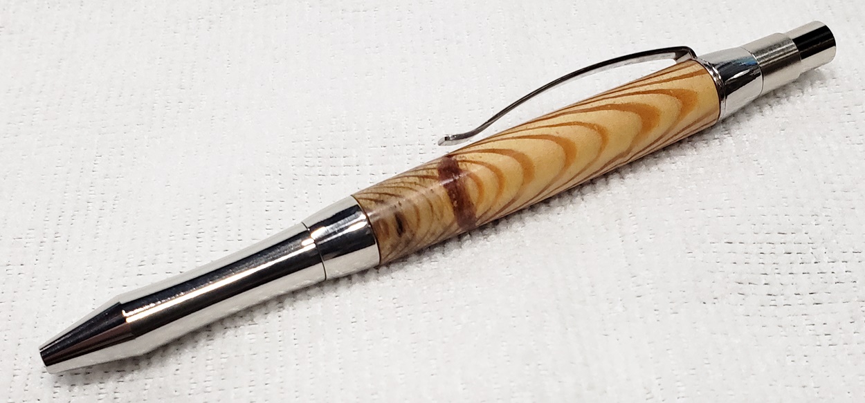

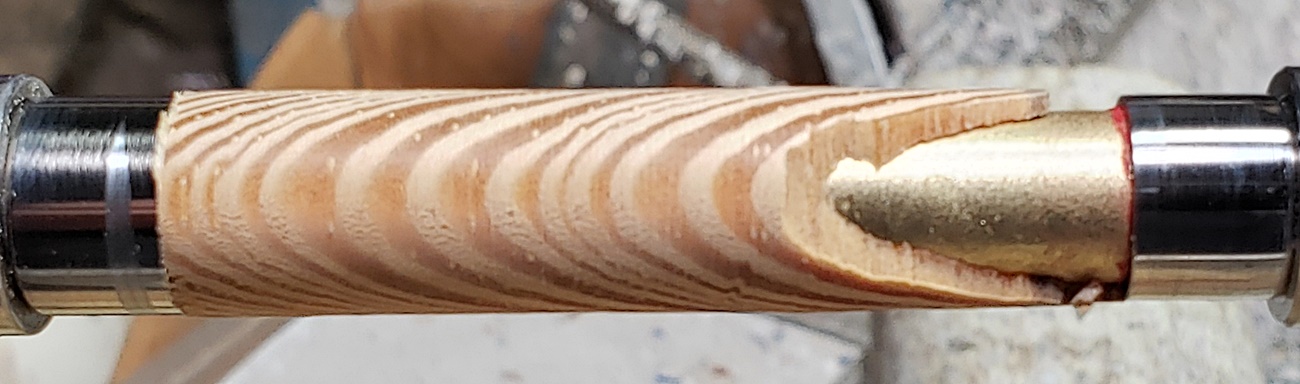

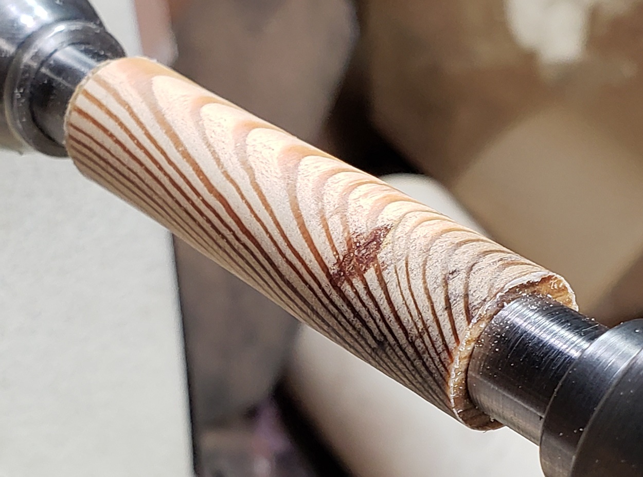

I rarely use negative rake cutters, but will on some occasions. The last time was on a piece of very old, very brittle douglas fir from the Goonies house. My son loved the Goonies movie when He was a kid, and I wanted to make him a Goonies pen. My first two tries failed miserably, so for my third and successful attempt I used a negative rake cutter.
