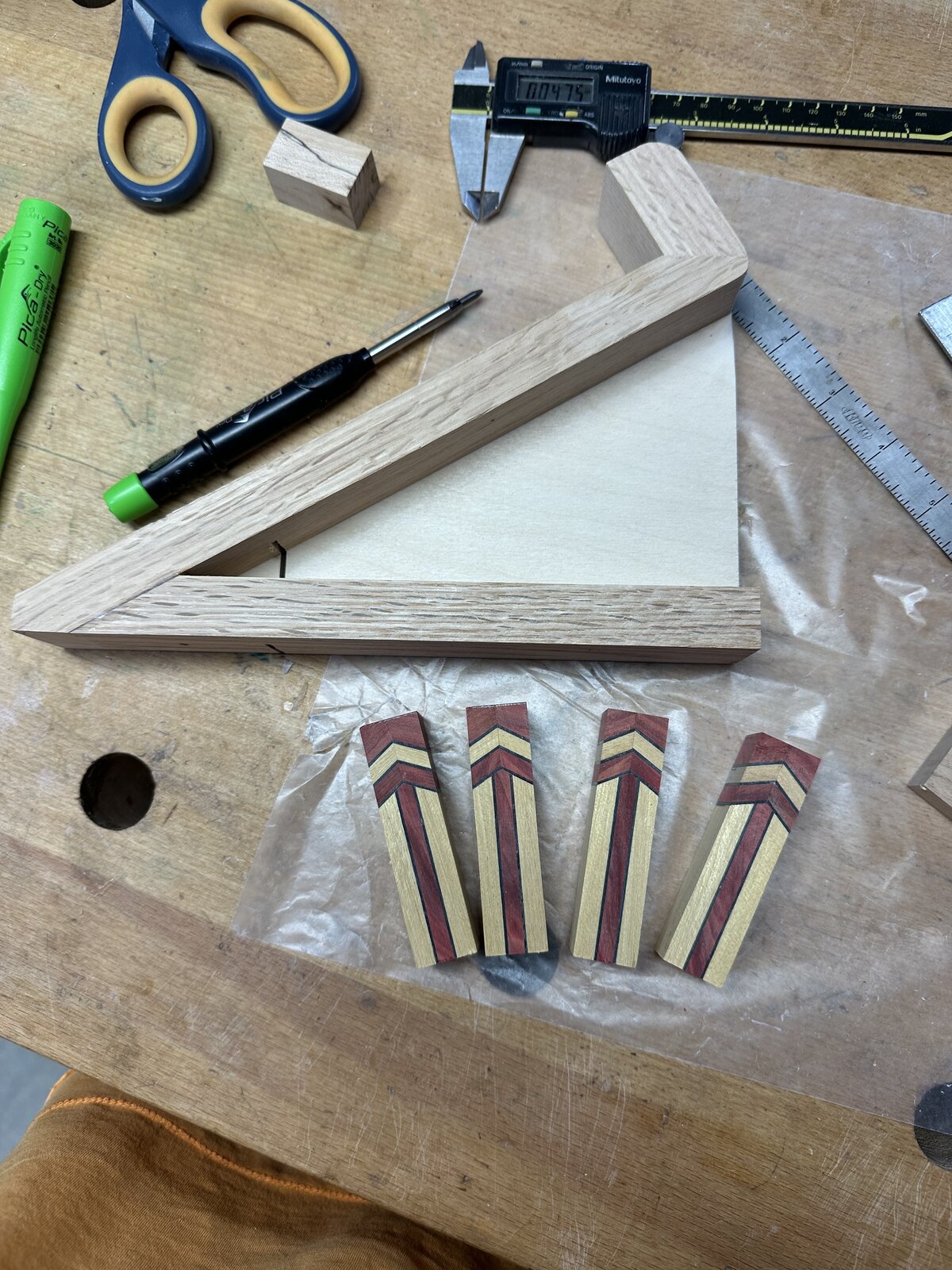

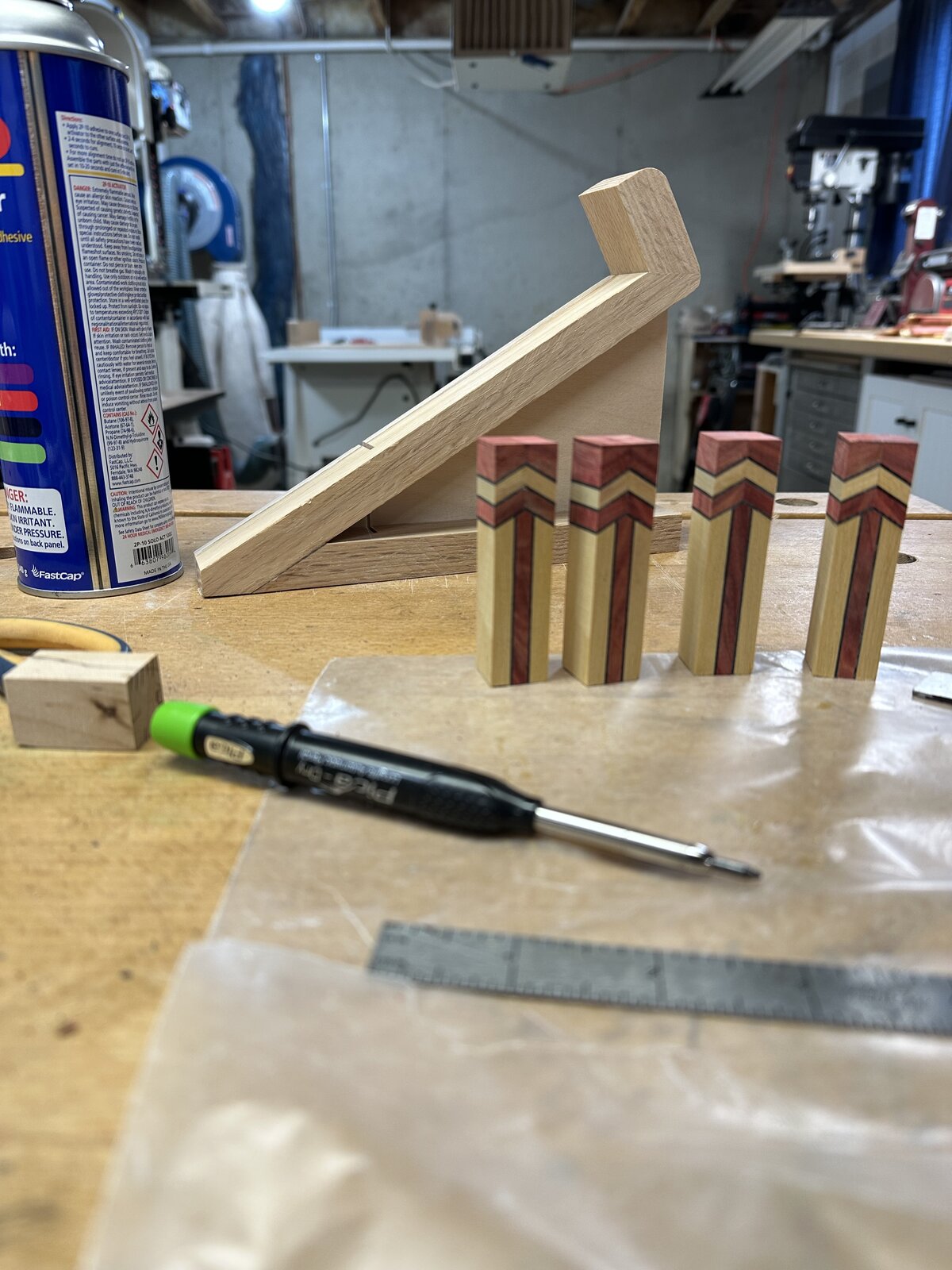

Built a new simplified jig to make Gisi blanks. Really makes Gisi blanks Childs play. Precision is pretty spot on, I'm a happy camper. 😃

Also can you turn one and show a finished product. Looks interesting. The jig looks like it can be expanded for further use also. Nice work.
Yes planning on turning one and I've already have another blank in mind to be made with this jig.

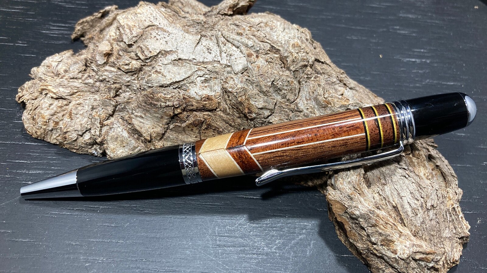

Ken, as the others, I would love to see your jig in use. It looks like it could really help with cutting the angles for the chevrons. I used a table saw sled with fixed angle guides to make this pen, but it was cumbersome.
