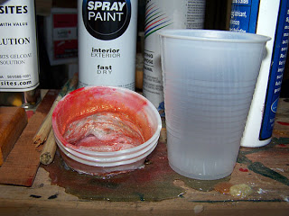

cups :
PETE - recycle #1 work great
PS - recycle #6 melt quickly
Yup. Here's a visual for you I just posted on my blog:
