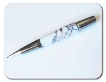

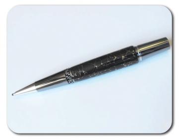

There is also an elegant beauty available that is a little bit shorter and the twist mechanism is up by the clip.
That one seems to me to be either a PSI Majestic Squire or a take off on it. The Majestic Squire has the twist the finial advance/retraction action.
The Elegant Beauty is from Dayacom. It uses a smaller tube (diameter and length) and, as far as I know, came out before both the Majestic Squire and the Sierra Elegant Beauty.
-Barry
I was thinking that the Dayacom Elegant Beauty did not have a finial twist....but I could be wrong on that.
-Barry
Smitty
The Dayacom Elegant Beauty is the orignal "Finial" twist of this style and uses a very robust transmission . Several months after it came out Berea introduced the (Sierra) Elegant Beauty using the the same mechanicals as the regular Sierra but with upgraded platings and a different centerband treatment . The Majestic Squire is also "Finial" operated , it came out much later and is also made by Dayacom but uses different sized tubes and the Majestic style centerband and clip .
