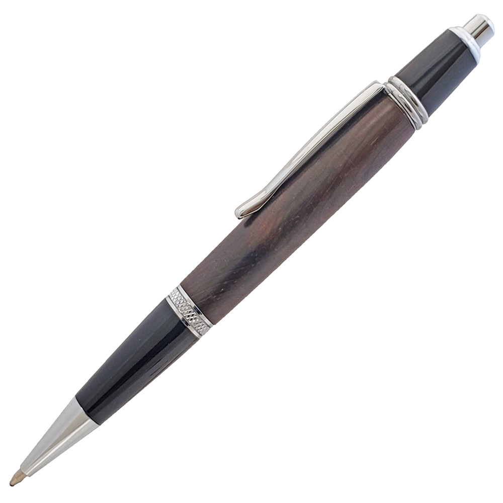

Does anyone have a source for replacement clickers for the sierra click pen. The insert is easy enough to unscrew from the inside and replace but I can't find a clicker except from a new kit.

the clicker comes preassembled in the cap but you can unscrew it from the inside to replace . That is the part I'm looking for. Otherwise you have to use one from a pen kit to repair one.Does anyone have a source for replacement clickers for the sierra click pen. The insert is easy enough to unscrew from the inside and replace but I can't find a clicker except from a new kit.

There is a complication, just as I thought. . And that is this .... there is more than one version of the Sierra Button Click.
The ... www.BereaHardwoods.com ... website listing currently refers to the introduction of a new version. .
Sierra® Button Click Ballpoint Pen - Chrome
Check out the deal on Sierra® Button Click Ballpoint Pen - Chrome at Pen Kit Making Supplies Berea HardWoodswww.bereahardwoods.com
And ... these two versions are both distinct from the newest introduction (late 2019), namely, the Sierra "Super" Button Click, which is a different kettle of fish, having a different barrel length, and having a Schmidt SKM-88 click mechanism for the first time. . I won't say anything more about the "Super".
The "original" Sierra Button Click (which I started buying in about 2010) had a metal extension piece (about a cm. long) which goes in at the top end of the refill, and you have to get that extension piece in the right way up. . With this model, if you unscrew the pushbutton (from the top) you will see a black threaded plastic internal plunger.
A later Sierra Button Click (probably the new version referred to currently on the website) does not have the metal extension piece, as I assume.
With this model, if you unscrew the pushbutton (from the top) you will see a white threaded plastic internal plunger.
The two push buttons, for the two versions, are threaded differently and are not interchangeable, even though they have the same outer diameter.
I believe it is also true to say that, apart from having differently threaded pushbuttons, the two versions that I am talking about (both of which I have in my possession) have different internal working parts. . I do not know which version you are concerned with in your opening post above.
So, Salty, your search for "replacement clickers" may not be a simple matter, as I see things. . You will certainly need to identify which version that you are dealing with. . And, you will probably need some expert help.
I suggest that you make a phone call to Berea, and talk to the head guy, whose name is Joe, I think.
Let us know if they make parts available.thanks, I do have the pens with the white click part. so I did email Berea and ask about buying replacement parts.
