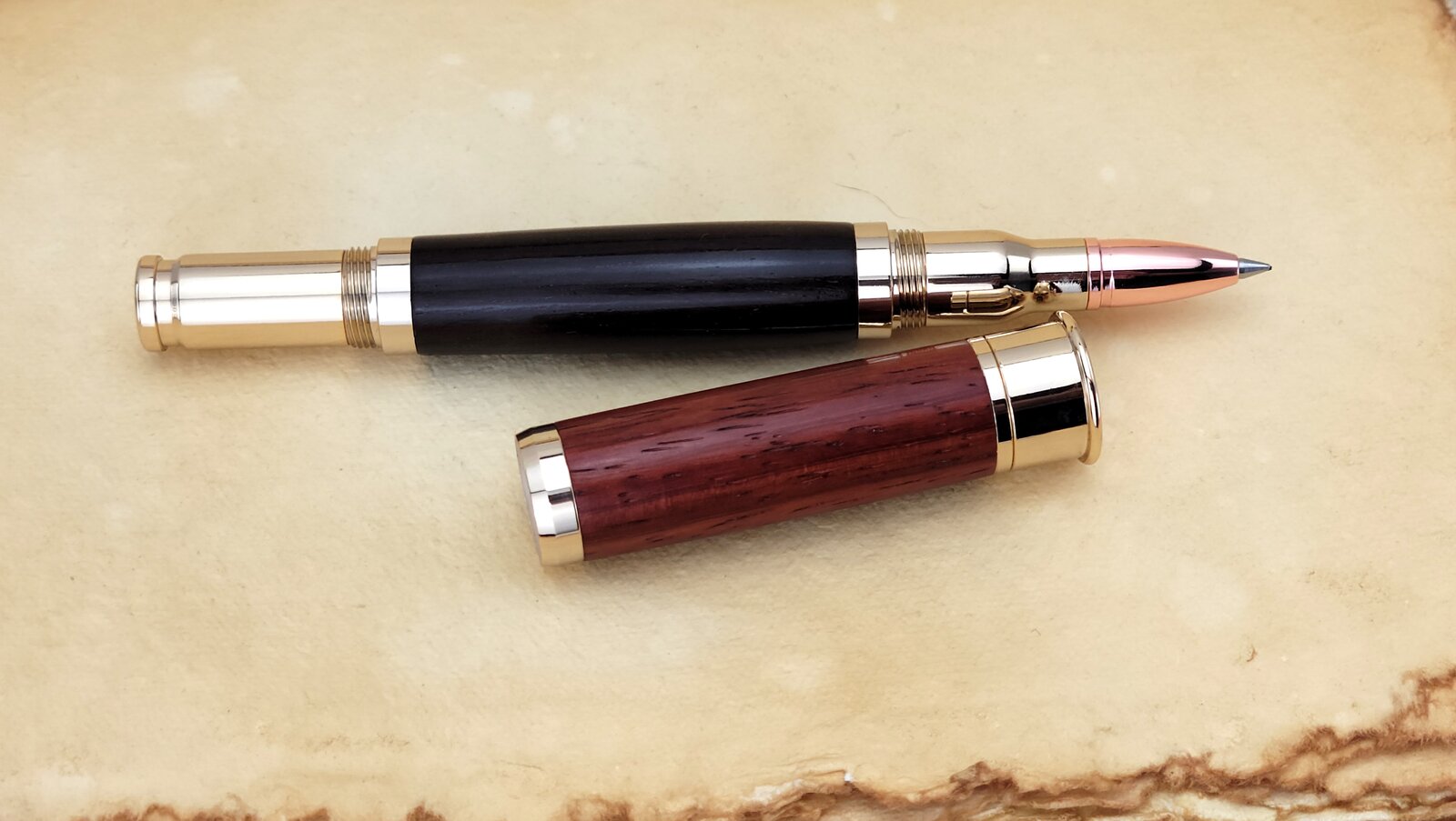

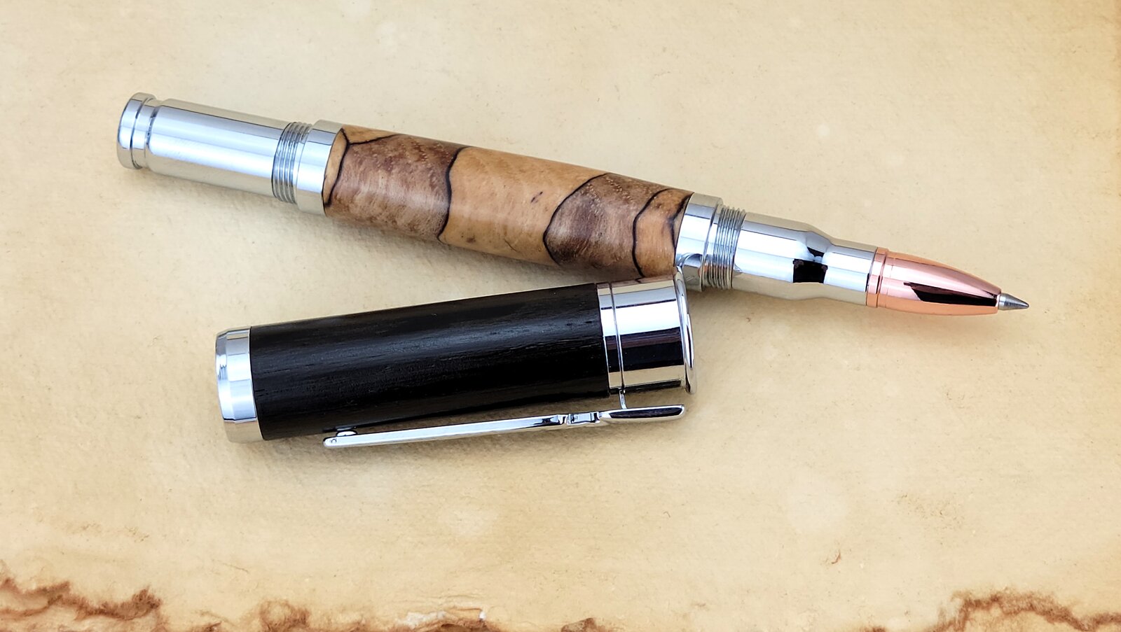

I've found that bog oak and padauk look great as the "shell casing" with the larger pores for texture. These certainly aren't fancy cast blanks, but maybe it will give you a better idea of what to expect from the kit.
I have also found that you need to be very careful to clean the threads of the cap so the section doesn't get scratched. The cap does take a 9/16 bit. It's a pretty big pen.
