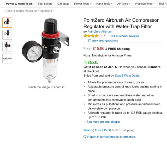

One thing I do regardless of the pot is put a pressure adjuster in the line so it will not over pressure the pot even if I leave it on by accident.
Here is a random example. I airbrush too so I use them to control pressure in the line at the airbrush outlet.

No offense meant, but if your worried about the Harbor Freight pot why would you put a Chinese made regulator on it; and then trust that when you won't trust a Chinese made pressure pot?
A similar regulator/trap made by a reputable company like Parker will run you over $200 alone.

I'm not offended. Quick picture as an example off the Internet to explain a thought process. The point was additional safety measures that are available not an endorsement of a particular product.

I'm glad your not offended :biggrin:, but my post was actually intended for the OP whom to me seemed to take your post as a direct referral for that particular item. I just wanted him to be aware that it was more than likely the same quality of Harbor Freight Chinese crap and his original post seemed to be against that.
