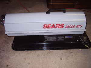

I was just given a Sears torpedo type heater in exchange for a pen... we have similar heaters at work that we use to heat the loading dock area, but those burn diesel.
This one says to use kerosene or #1 fuel oil.
Kerosene is pretty expensive in those one gallon cans at Lowes, and I cannot locate a service station that sells it...
What is #1 fuel oil?... can't find anyone around here that has that either!
So... am I stuck using kerosene from Lowes?

Marc try and locate a petroleum distributor, (not a gas station, but the folks they buy from) #1 Fuel oil is what a lot of places up there in Yankee land use for heat, Kerosene is expensive any where you find it, Fuel Oil might be a bit cheaper.
#1 fuel oil is also known as #1 diesel. #2 diesel is the usual fuel for vehicles but #1 may be available, especially in winter.

If you find someplace that sells diesel fuel the stuff that does not have dye in it is #1 the stuff that has dye in it s #2 it is also called off-road diesel fuel they cant use it in trucks that run on the road it is for Farm equipment and School Buses. As someone else said #1 diesel fuel can be bought at any truck stop, I would imagine that you should be able to use off-road diesel fuel in it that is quite a bit cheaper. #1 fuel oil is about 2.399 a gallon right now just got some for the house. I have used diesel fuel in my Furnace in a pinch when ran out and couldn't get any delivered until the next day or something so it should work in the heater.
