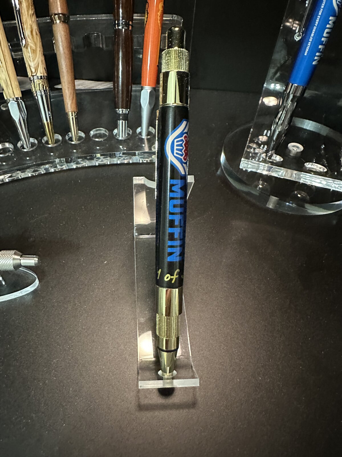

Good afternoon dear collective,

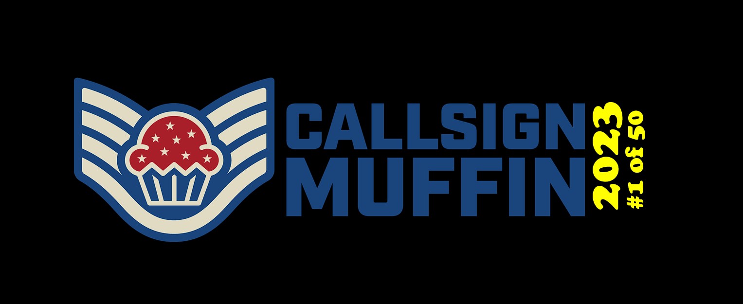

I am trying to help my blank maker. I am trying to come up with fundraiser ideas for a nonprofit organization and came up with a numbered series pen. Below is will attach a picture of my idea. I was thinking of using the "look" of "gold flake" or ""silver flake" but not actually use that material for the "year" and "number" on the pen.
Is there an ink, or something that would be fairly inexpensive to use to bring out this effect? Has anyone ever done something like this? Is there a "foil" that could be used?
Thanks for reading :)

There are gold or silver felt tip pens that maybe can be used to create the design. Cast over in resin. I've seen these pens at Hobby Lobby
"Shimmering" fountain pen inks are available. I bought the sampler below. It's not like gold leaf or anything. I'd describe the shimmer on most of these as subtle.
Are these inks castable? - I assume they are once they dry, right?

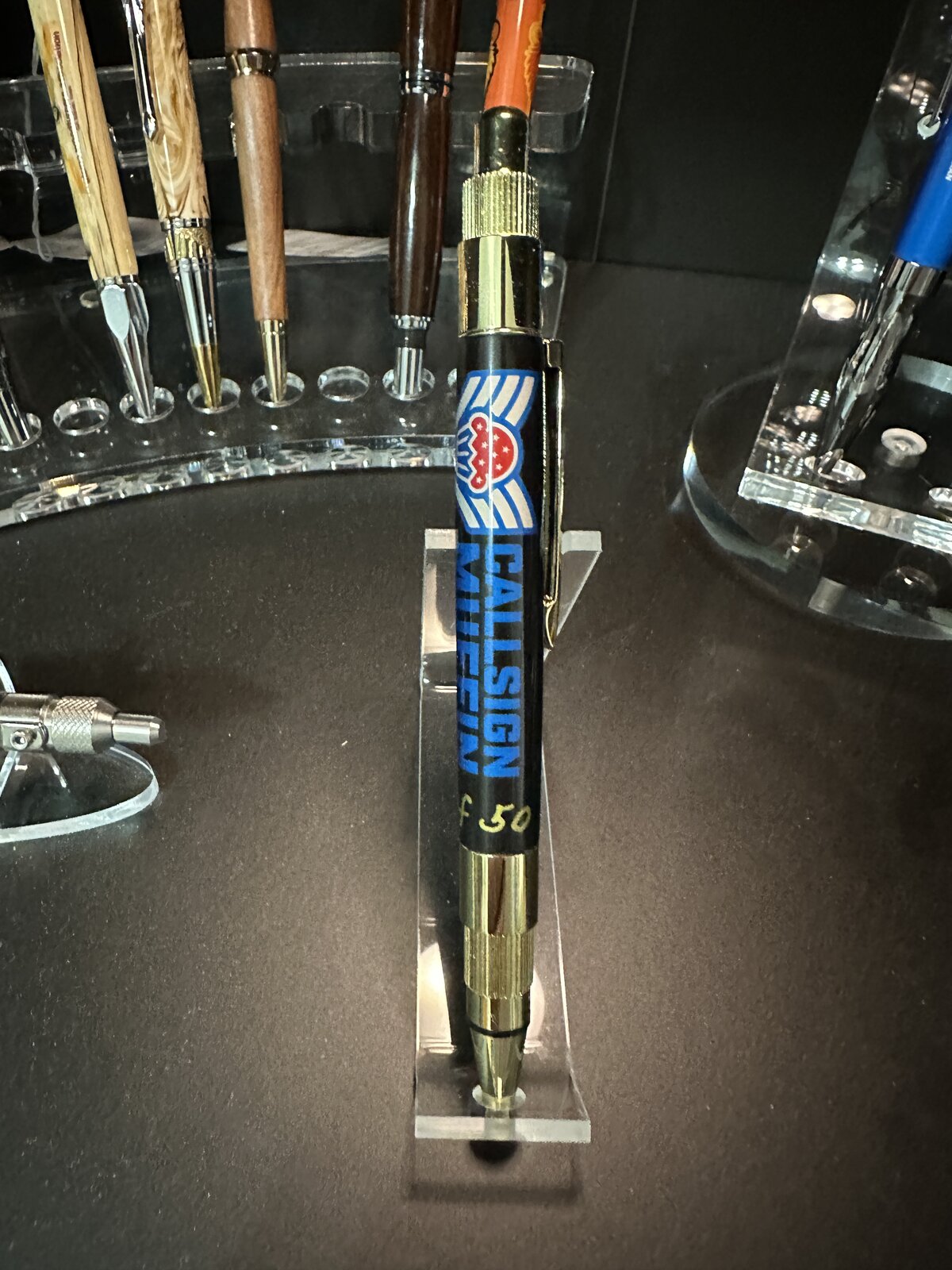

We used a set of paint markers and it worked wonderfully! Thank you for the suggestion. They came out real nice on the gold finished stratus. Thank you again, Drew
I used gold and silver metallic pens from Hobby Lobby to write on custom fishing rods. Write, let dry and cover with one or two coats of rod building epoxy.
