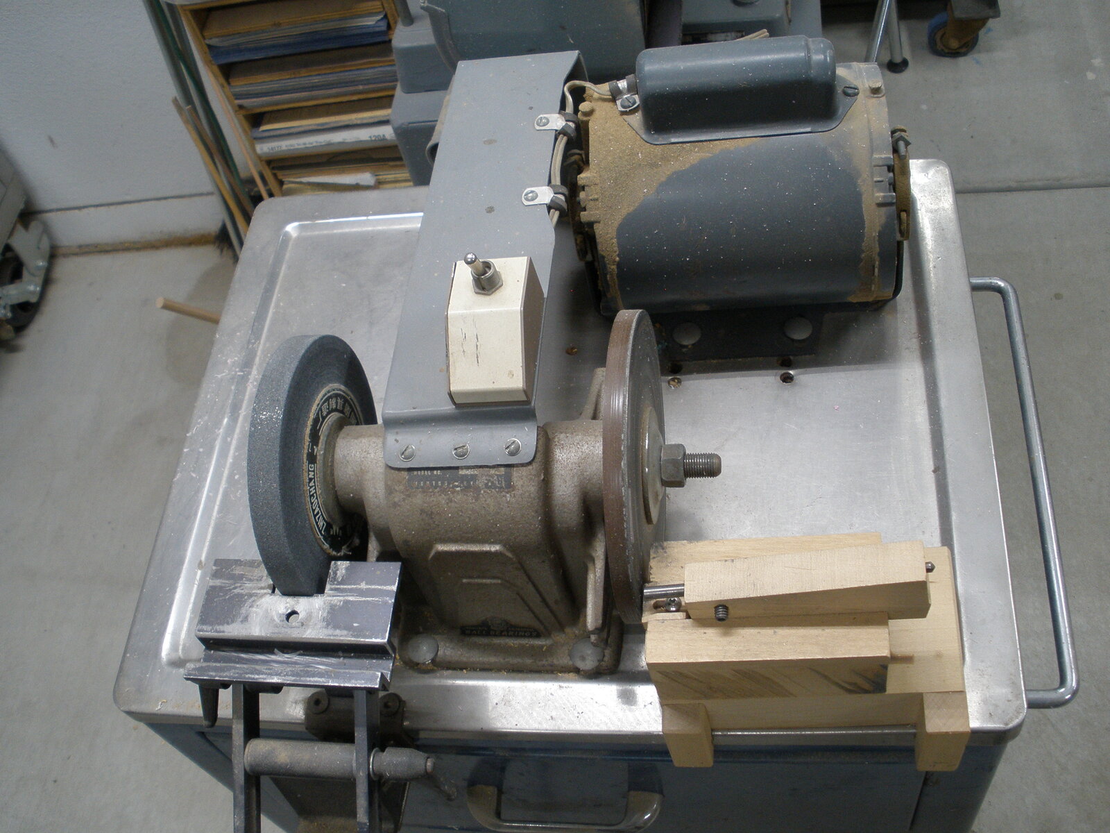

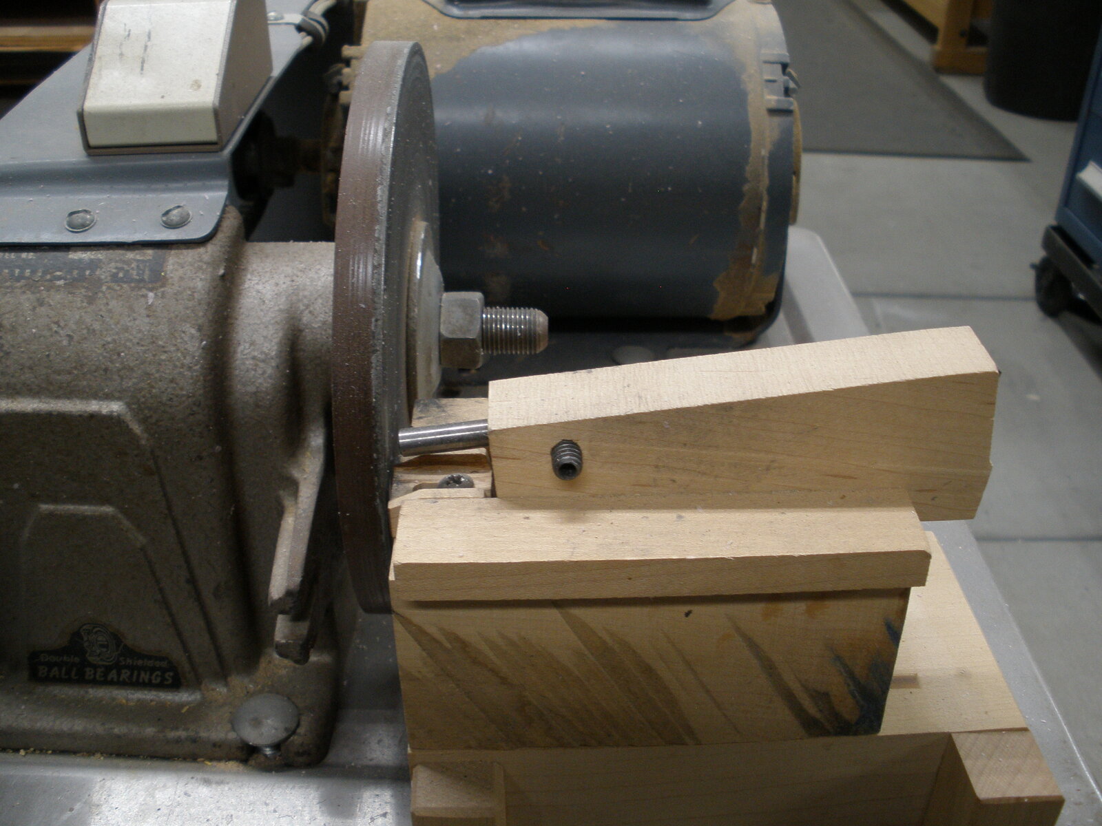

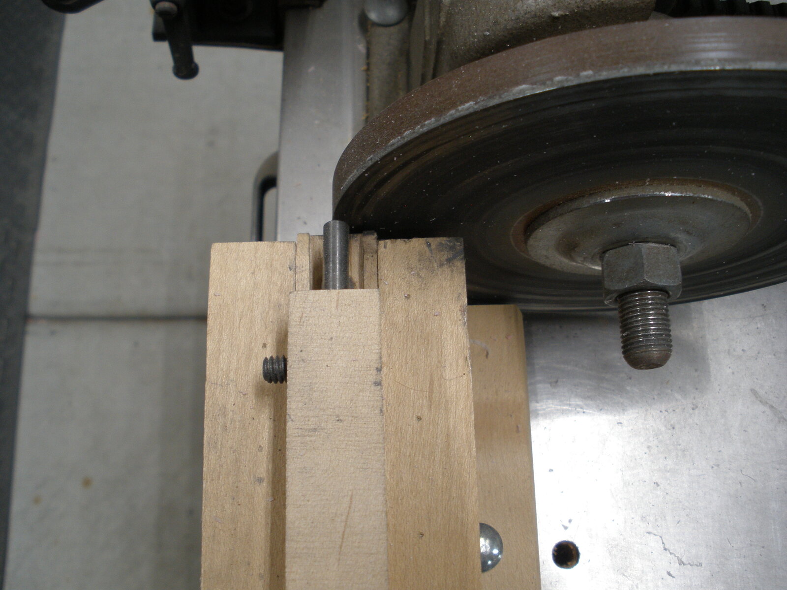

I too sharpen my pen mills, not only the back side but after a while even the edge needs an occasional touch up. I made a jig which mounts to my grinding base and use a diamond wheel on the little grinder, I can touch up each blade for an extremely sharp edge.

Would you be willing to share a photo of your jig?
I hope these come through, if so I do not remember the angle I cut the jig to, it's been quite a few years. the shaft I used is only an old drill bit the same diameter as the shaft on the pen mill. I do have an adjustable stop to keep the cutters to the same distance to the wheel and I just use a mark on the top of the jig to align each blade before sliding it to the wheel. the set screw is used to tension the shaft so it will rotate with a bit of pressure. All in all pretty simple but it has been working for a number of years now.

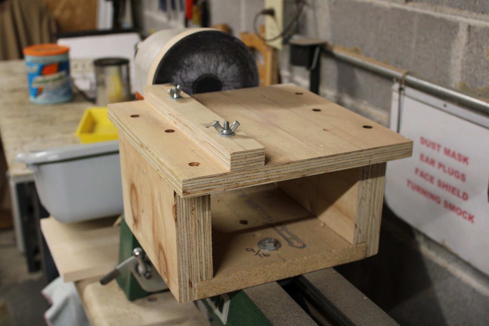

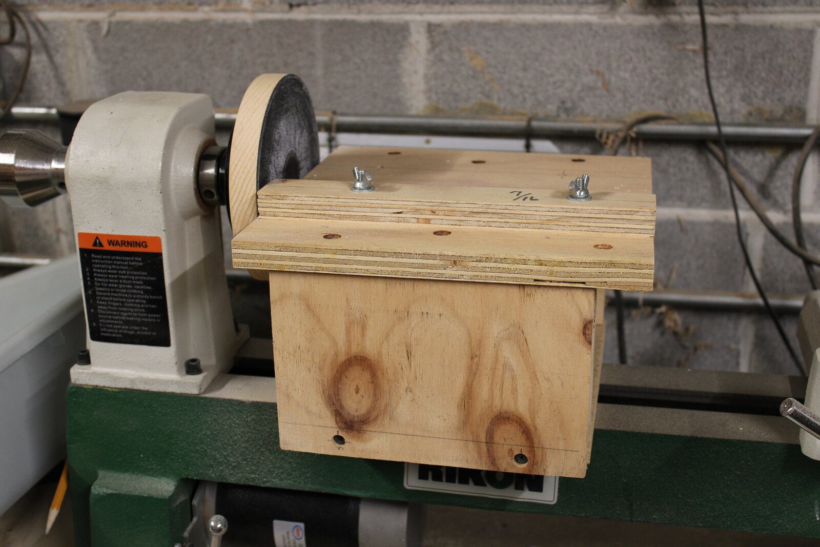

I'm pondering using a sanding disk setup for the lathe I made several years ago. If, and a big IF, I was turning and selling pens on even a part-time basis, I would go with the Woodpecker set. I see it advertised in Woodturner magazine. "Why didn't I think of that?"
I use a Droz precision square to set the disk and the moveable side to 90 degrees. It works!
