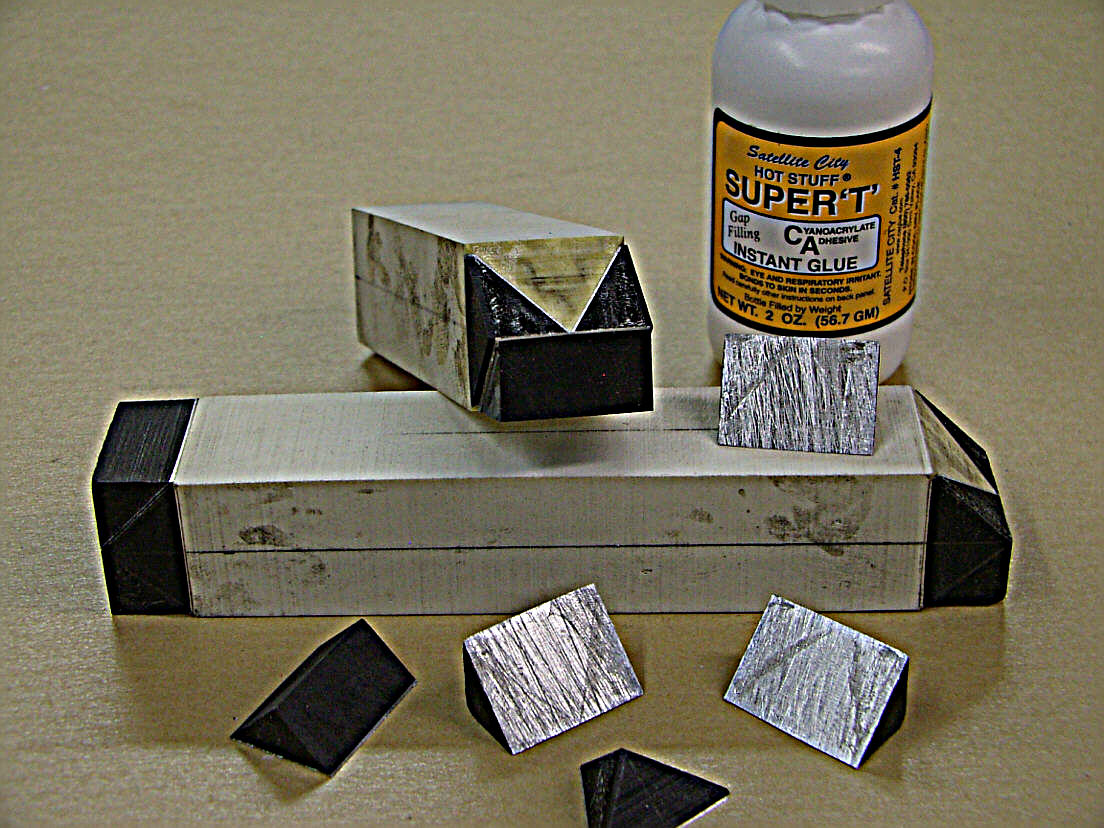

CA is not the glue when using metals. You have 2 things going against you. Metals which has no grain to absorb adhesive and the bloodwood is a hard exotic oily wood that it to has little grain to adhere. If you are going to have a chance I suggest an epoxy that takes 24 hours to cure. That 5 or 15 minute epoxy does not have the holding strength as 24 hour such as System3 T88. It is the strongest epoxy that I found that I use with segments. I have shown this here before but here is an example of using CA and metal. The next day I went to do another step with these blanks and the scallops fell off in my hand with no pressure or heat applied. Not a fan with CA. Now that is not to say I have not used CA for a blank segmented. In fact I have 2 blanks I am working on right now that all segments are glued with Med CA and the woods are Gabon ebony and holly. One I have already turned and finished and did fine with drilling and sanding and turning. But when I added some trim rings which were aluminum I went back to epoxy. The center blank was 4 parts so there was alot more glue surface. I will show all these pens in April when I get them done.
