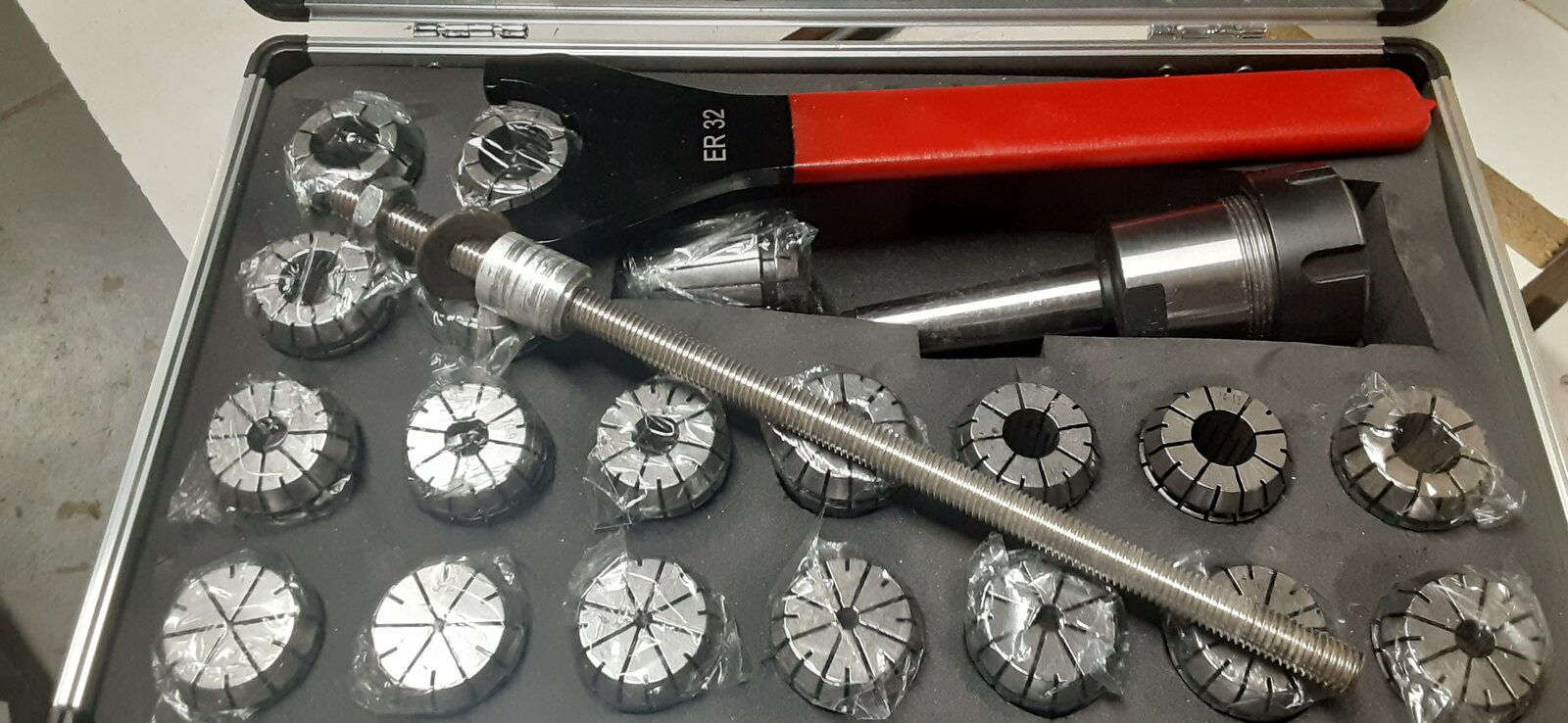

I bought this set, probably on amazon. Mostly used to chuck up a ring mandrel pretty happy with it, obviously I have only used a few sizes. But whatever you get, plan on a draw bar. Without it, the chuck will want to come out of the morse taper. I just grabbed a long threaded rod. Also, I think some sets might not have a case. Get one with a case to keep everything together.
I bought this set, probably on amazon. Mostly used to chuck up a ring mandrel pretty happy with it, obviously I have only used a few sizes. But whatever you get, plan on a draw bar. Without it, the chuck will want to come out of the morse taper. I just grabbed a long threaded rod. Also, I think some sets might not have a case. Get one with a case to keep everything together.View attachment 375455
Glad you mentioned the draw bar. MT tools in the headstock with no drawbar are an accident waiting to happen. The ones mentioned in this thread have been screw on collet chucks.
