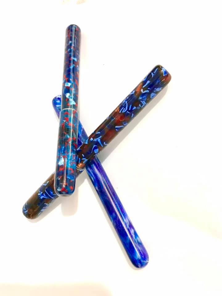

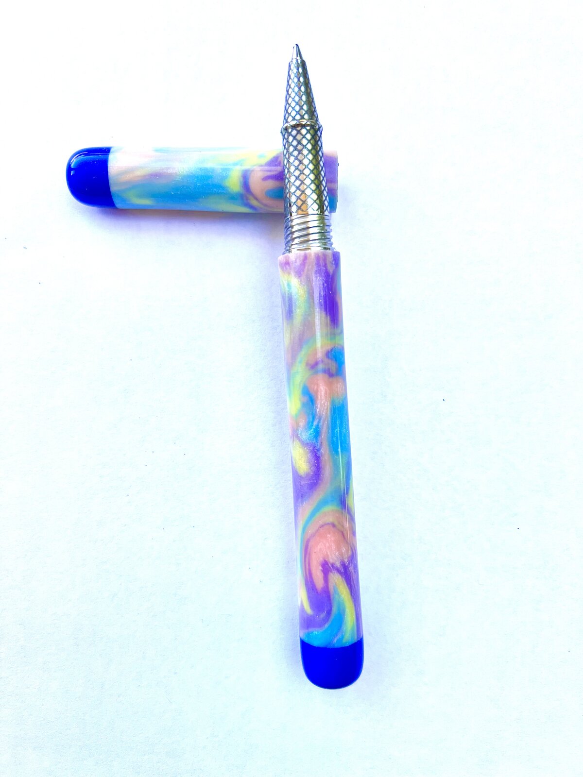

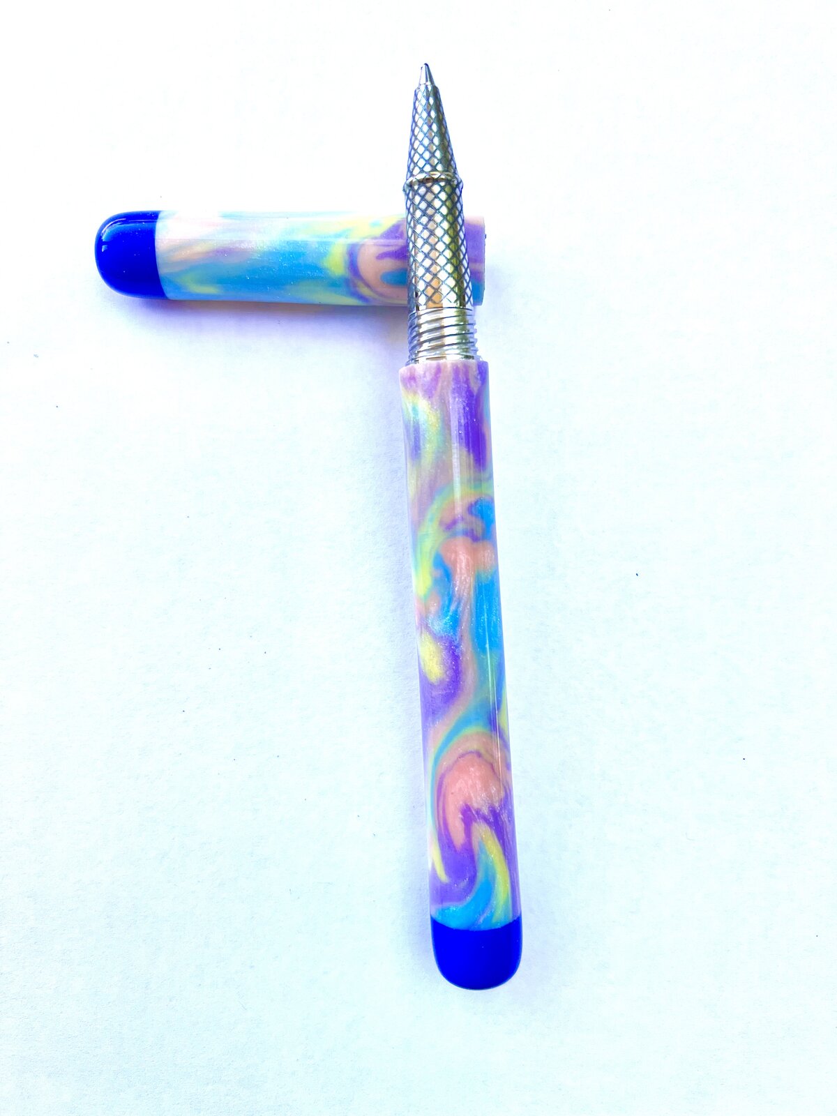

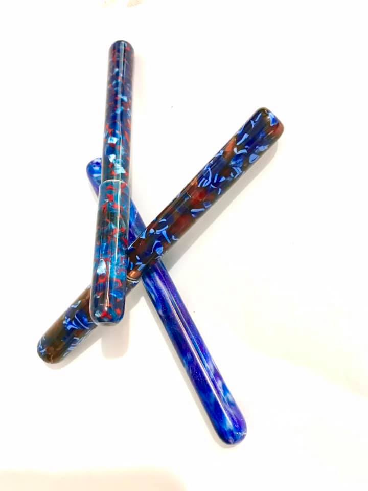

Dave,
Here are some Apollo Rollers I recently made. I really like these.
