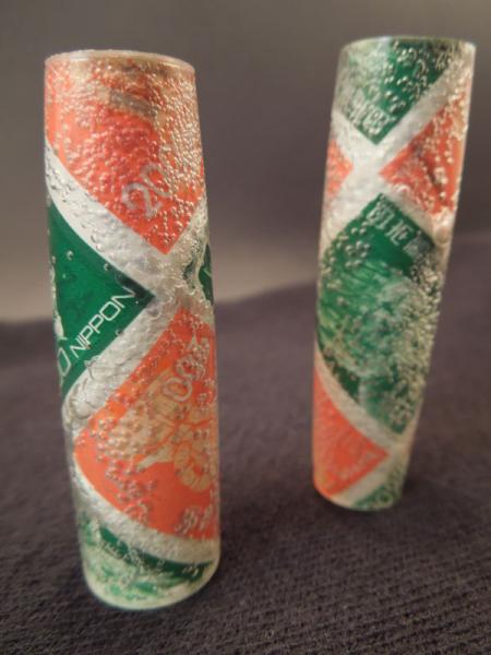

I attempted to do two postage stamp pens. The second one turned out pretty good and I put it in the Show Off Your Pens thread. This is the first one. What I THINK happened is that I got the mix wrong on the Alumilite Clear. I measured equal amounts of A and B, poured them into the mixing cup and mixed well. Put it in the ugly homemade mold and pressurized at 50 PSI. However, when I went to throw away the measuring cups of A and B, I seem to recall that one seemed slightly heavier than the other, like I didn't pour all of it out.
I also had some of the mixed stuff left in the mixing cup. (I actually think I like a little left over - at least so far - to estimate how far along the curing of the casting in the pressure pot is going.) Anyway, the stuff left in the mixing cup took a very long time to cure. As a matter of fact, it was pliable and not very strong (I could break it easily) for probably around 5 hours or more. Anyway, when I took the mold out of the pressure pot, I decided to let it cure for another 24 hours. When I turned it, it was air bubbled to extreme! I'm guessing that since it took so long to cure and was a hard jelly for so long, air got in where it wasn't supposed to. So that's my hypothesis. Do you think that's what happened? Any other ideas as to how this would happen?
For my second postage stamp pen, I measured exactly. I measured the A and B cups before mixing and afterward to make sure that they were equal and it was truly a 50-50 mix by weight. No air bubbles.
Comments and suggestions appreciated! Thanks! Greg

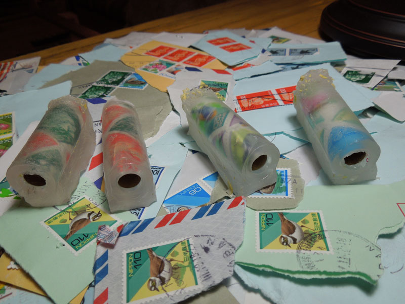

OOPS! My measurements were by weight. I didn't weigh the A and B cups after pouring into the mixing cup though. My post does not make that clear - well about as clear as my bubbly blanks. I'll edit it now. Thanks so much Jim and Charley!
OOPS! My measurements were by weight. I didn't weigh the A and B cups after pouring into the mixing cup though to make sure that all of it was mixed together. My post does not make that clear - well about as clear as my bubbly blanks! :rolleyes: Thanks so much Jim and Charley!

When I mix Alumite I zero the cup, pour Part A in the cup, mix my tint if I am tinting, Zero the cup again, pour part b in the same cup Slowly as to not go over. I have never tried to weigh them seperately becasue I thought about what you were saying and the fact that I would never get all of B out of the cup.
As for the bubbles.......wow, I have no idea. I use 50psi (my pots max) and have never seen that. Could there have been air trapped between the Stamps and the tubes that escaped? I dont see how but it's all I can think of.
Did you cover the stamps with some medium prior to casting?
Some people use Modge Podge to put a protective coating on the stamps.
Alumilite hates the slightest hint of water and I believe Modge Podge is water based......
Yeah, that looks like a reaction to the adhesive. Let it thoroughly dry and then seal prior to casting.
I'm with Justturnin on mixing Alumilite. I use a digital scale for measuring the weight and only one cup is used unless I'm mixing multiple colors for the same batch.
Also, heat your molds before pouring. That will help provide more consistent results.
Tom
Thanks! I did spray them with an acrylic clear spray. I don't think it was water from the tubes or spray. My glue was spray mount. If water is present (even the slightest amount), are bubbles the result?
Thanks! The way I did it, I used three cups. Probably a waste, but one for part A, one for part B, and then a bigger cup for mixing the two. Then, when I reweigh the A cup and the B cup after pouring them into the mixing cup (which I didn't do in this case, but did on the second one), if they are still equal, then I know that I got equal amounts by weight in the mixing cup. I guess there could have been some air inbetween the stamps and tubes, but I don't think so.
Tom
Cool! Thanks! I like your suggestion! Greg
Yes. If water is present it looks like boiling.....
If you use a water based glue as Modge Podge, you just have to let it sit for at a minimum of 24-48 hours to allow the water to fully dry.
I like to coat the stamps with CA to seal them but as people say, YMMV. Each person does it differently. You just have to figure out how to do it without introducing any water or moisture. Even humidity will cause failures....
