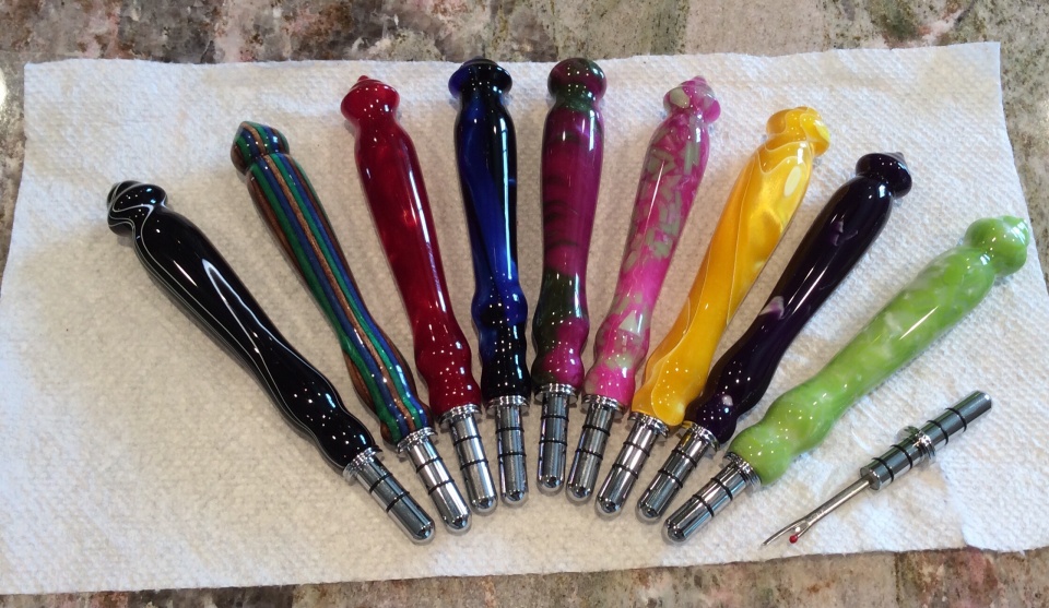

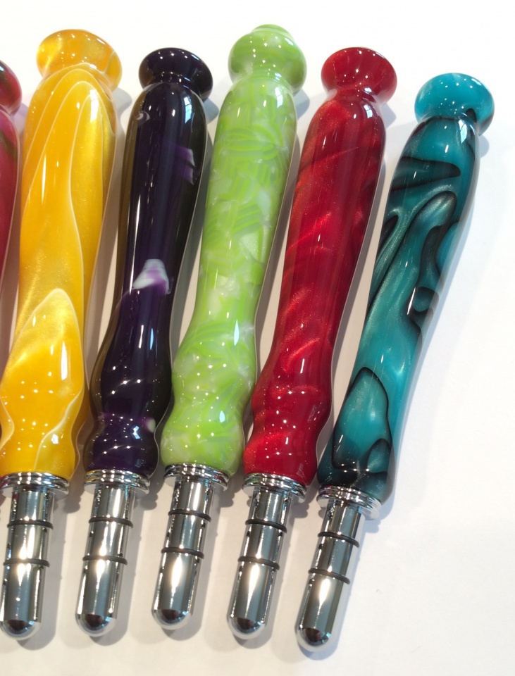

Here is a quick pic of a few seam rippers I have turned. All are acrylics with the exception on one made with colorwood. The colorwood has a CA finish. The components are from Woodcraft.
I like making these closed end and not using the clip or finial. The added length feels good in the hand.

That finish just glows!
Looks like you found a shape you like.

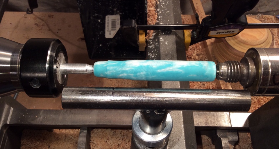

how are you holding them for the closed end effect?
I Love all these especially the lime green one.
Didn't have a knock out rod the right size to use in my collet chuck. In the past, I had used a knock out rod in a drill chuck with tape wrapped around it to get the blank to fit tight. Sometimes, it wouldn't run true.
This time, now that I have the collet chucks, I went to Home Depot and bought a piece of 3/8" aluminum rod, cut it, chucked in the collet and turned the end down to fit the 8mm tube with a snug fit. The rod goes all the way in and bottoms out in the hole. The tail stock with a live center not only holds it true and gives support till ready to part off the end but also gives lateral pressure against the end of the rod to help keep the blank from slipping.
I did not leave a shoulder like a bushing at the open end as I wanted to be able to work the end right to the edge of the tube.
After turning, doing most of the sanding, I part it off and finish wet sanding and then use the polish.
I then remove, use a flat file to clean up the end at the tube and then buff away!
I will get a pic for you later.

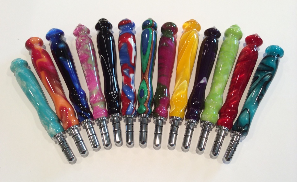

Here is another pic. I added more to the collection.
Yesterday, a quilting store bought 4 of them to start with!

I had some older PSI seam ripper kits which used a metal sleeve inside the tube to hold the seam ripper in. Sometime they caused issues and scratched the metal finish. The Woodcraft ripper uses O-rings which slide right into the brass tube. Since I am making these closed end, I can put one back on the lathe if I needed to return or wet sand for some reason. Also, the ripper does not get scratched at all. The end of the brass needs to be chamfered and smooth.
I also sprayed a little silicone spray lube on a Q tip and rubbed a little in the tube so the o-rings would slide easier.

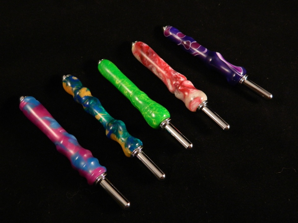

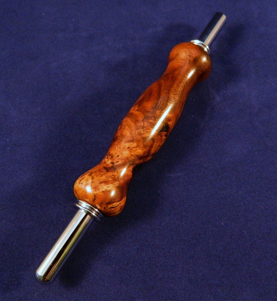

more rippers made
Nice oak burl
