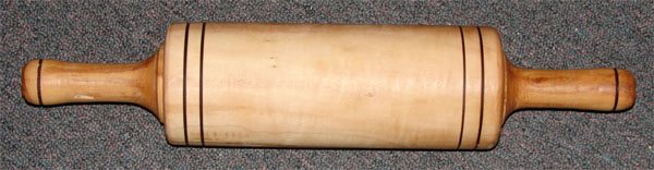

I just turned a piece of Bradford pear that was a branch about 5" in diameter and a little more than two feet long. It was cut about two years ago. I slabbed the sides and sealed the ends with Anchorseal. It was very-very hard. It would have turned better (I believe) a year ago. Nevertheless, my wife was happy with the results.
