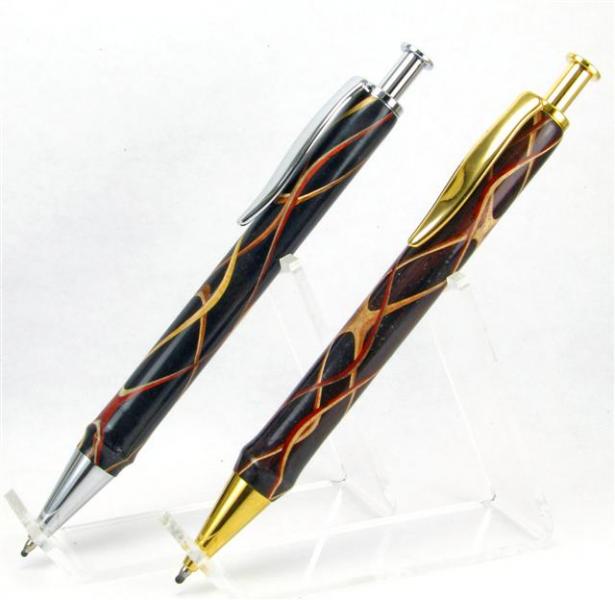

attachment.php
Here's a couple of Long Clicks scrollsawed by a friend of mine. He didn't feel they were worth the effort of turning them into pens. I did!:biggrin:

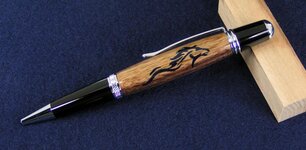

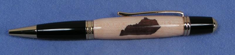

I've used my scroll saw for a few pens. Not always segmenting, though.
