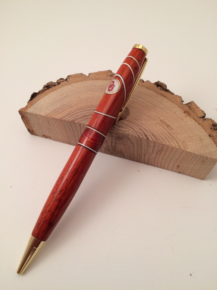

Thanks for this tip. I have a Scalloped Trimline but its still a work in progress. But I made this one with the bushings from a Chicago/Manhattan. IMG_2534.jpg

Thanks for this tip. I have a Scalloped Trimline but its still a work in progress. But I made this one with the bushings from a Chicago/Manhattan. View attachment 142707
:eek: Now that's a modified Trimline !!!! Nice work on this eye popper !! Jim S
