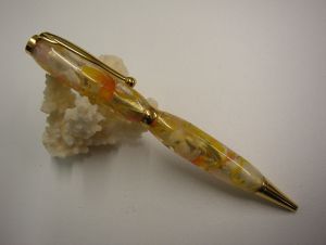

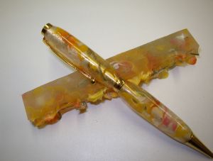

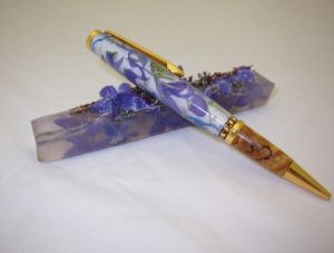

My silk flowers I was VERY pleased with.
Pom poms, pinecones, seeds, leaves, fabric, labels... go through the member photo albums or use the search engine with just about anything you can think of. If you can dream it up.... chances are it's do-able!!
