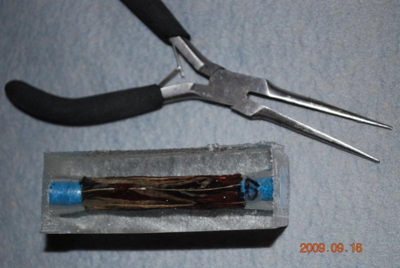

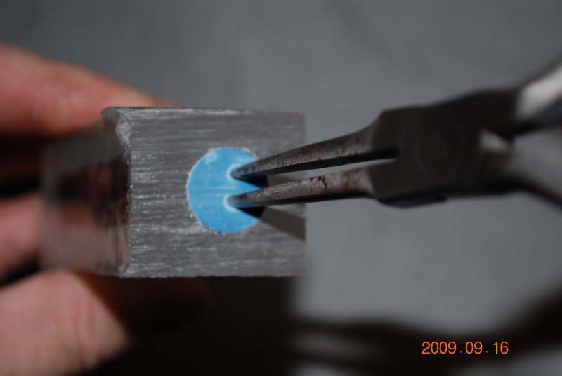

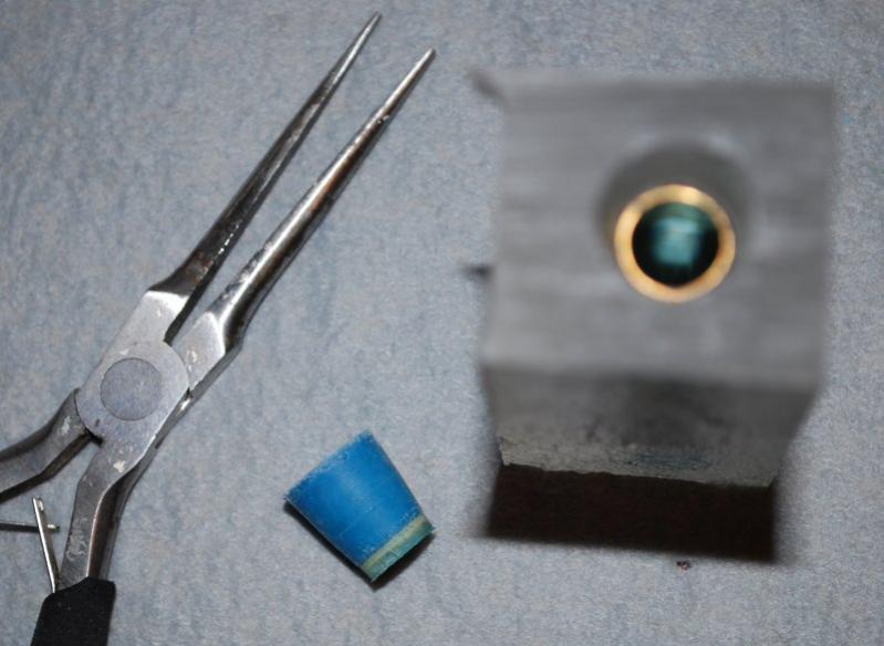

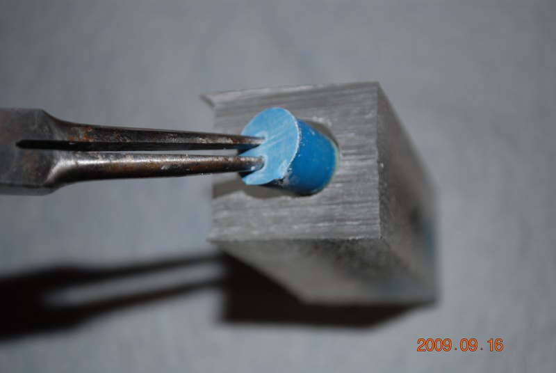

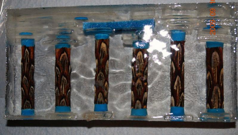

Tom, This is how I use them. I push the blue corks in the tubes and glue to left over resin scraps and wedge in the molds so they dont move around. Take out the block, cut them apart and then cut at the top egde of the blue corks. Then push in on the sides of the corks to loosen them from the pr and stick the pliers in. Then I squeeze the pliers, pull but not straight out, kind of like a bending motion. Then I cut off the extra resin, mill the ends down, and reuse the corks. I often get three or four pours on on cork before its too short to use. Sometimes they tear but thats why I buy 500 to 1000 at a time. Hope this helps. John
