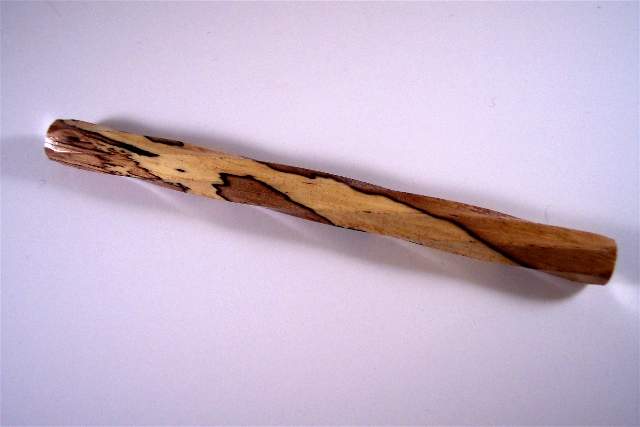

Hey Patrick, I used a Dremel #654 - 1/4" router bit (overall size and not the shank size obviously) doing the cuts on the side, turned out quite well, I made them in two passes, with the second pass at a faster pace than the first, using the 4th speed on my dremel that has six speeds...here's a pic :wink:

Patrick, I've now experimented with doing the 'rope twists' with the 'Beall' supplied cutter and although it does a nice 'small' rope, I really think you need to move up to Don's recomendation of using a 'foredom' to utilize the 1/4" shanked rope bit from Magnate to get the familiar looking 'Rope Twist'...:)
Also I wanted to mention that I've now received my 'Beall' straight cutters and they work very nicely on making the 'Hex Twist' on the wizard with the Dremel! :cool:
