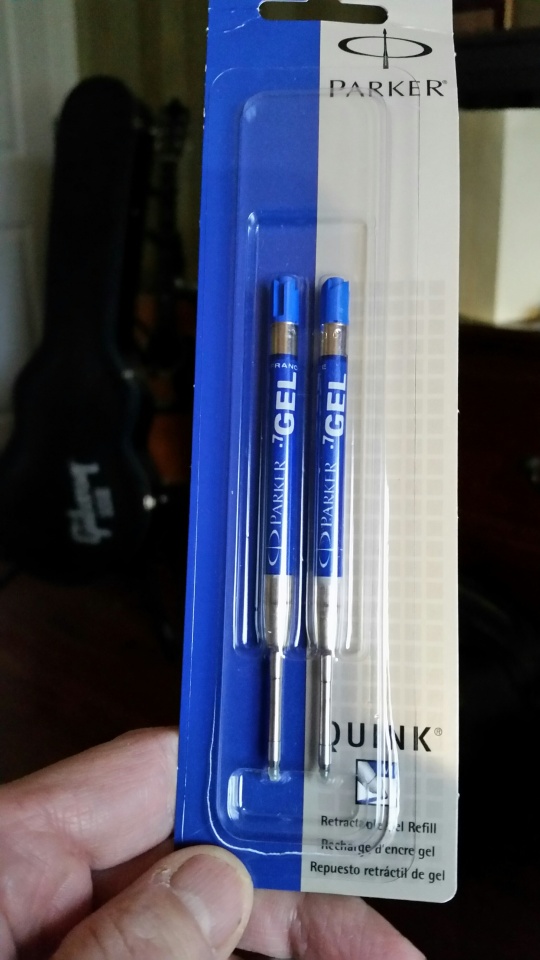

Not a kit, but the Parker Gel that I mentioned
I just received today, they were given high marks on some pen aficionado site. I will report if I like them better than the Montverde.
The brand is called Parker Quink
