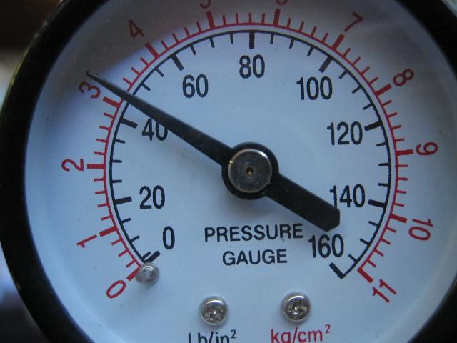

I'm happy to report that we're now at about 13 hours and it has yet to drop in pressure!

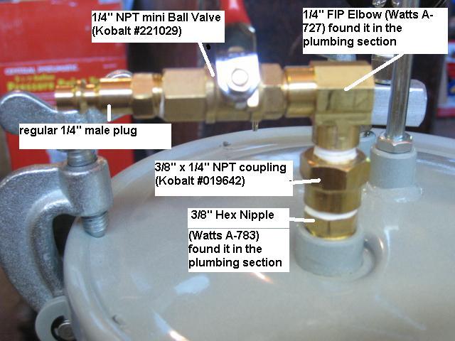

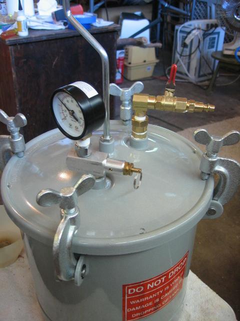

OK. Here's my incarnation of Scott and Firefyter-emt's pot. I like this because there's not a massive amount of brass. I like Scott's because of the combo gauge that I have yet to find. When I do I'll replace the gauge on my pot.
Since there were leaks everywhere, this version serves me better because I don't have so many places for errors - I need all the help I can get! Teflon tape is a good thing.
I am using a puny air compressor I got last weekend from HP (2 gallon tank) and it takes a couple of pulls to get the pressure up to 45 psi. I am planning on returning to HF to exchange it for a bigger compressor.
The brass fittings were purchased at Lowes, a couple in the plumbing department near the pvc pipes and the other two near the air compressor gadgets (ball valve and the 3/8 to 1/4 coupling). Why they're not all in one place is beyond me! I had the extra male plug from the stuff from HF.
So 5 pieces of brass to get the pot going. Not bad at all. Could've been 4 if I could have found a combination piece to get from the pot to the elbow joint.
Anyways...as promised, here are some pics of my completed pot.....
1st photo - completed pot under pressure; 2nd photo - annotated pic of brass; 3rd photo - 45 psi after 18 hours!
