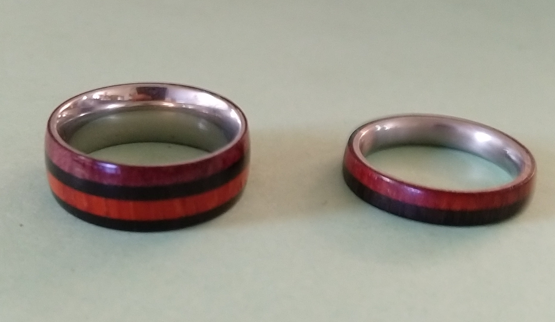

I have also found you can just purchase flat rings and add the wood yourself, as I have done below. I've thought about doing an explainer on my method for making these, but here's a couple examples.
The wider ring with a metal core is African Blackwood, Padauk & Purpleheart.
The thinner ring with a metal core is African Blackwood & Rosewood.
The wood ring is African Blackwood, Rosewood & Maple.
Finished with CA glue.
