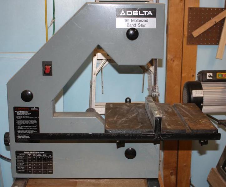

I am upgrading from this......16" Delta. It is really old..... Anything will perform better than that one did.

Looks like a Craftsman saw I see on CL all the time. What didn't you like about it?
/threadjack
It was just a little under powered and difficult to get blades of good quality.
The three wheel design made thicker kerfed longer life blades a no-no because they couldn't make the turn without causing stress fractures and breakage. If you don't mind buying the cheaper blades and continually changing them, then I guess it was fine but I was just looking for more.
