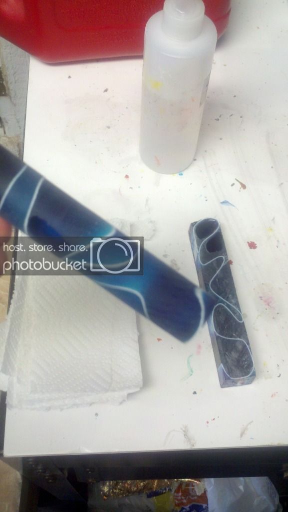

Instead of making my own ribbons (PITA!) I searched out some thin plastic sheets that would work. Did a couple trials that seemed to work out well. Never got around to finish turning them before my surgery & moving. Now I don't even know where they are. Gonna have to try and make some more I guess.
On a side note: If you can make your own thin ribbons go for it! This plastic worked, but I think the finished product would look better with PR ribbons.
These are some of the perforated ribbon material I was asking about a while back. It can nice some great looks with the right colors.
These are the ones they sell at WC from beartooth woods
