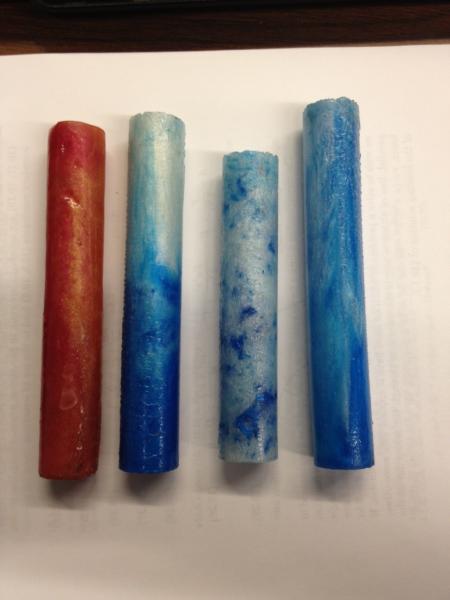

So here are the results of my first casting attempts (in order from left to right). I was aiming to create well defined swirls but my timing still seems to be off.
The basic parameters for each cast was:
2oz blanks
1oz one color
1oz another
Each had a pinky-nail size amount of mica powder added.
5 drops of catalyst for each oz.
garage temp ~60-70F
The resin was placed in warm water (heated in the microwave until the water was steaming) for the entire process (mixing mica, adding MEPK, mixing until it began to gel) ***In retrospect this probably caused the PR to cure as fast as it did. ~5mins***
I'm still trying to figure out the timing needed to pour the resin to get the swirls.
1st cast poured too early
2nd Timing was too late, one of the resins solidified mid pour so I had to remix a new color and pour before the blue go too hard then it wouldn't mix well.
3rd the blue cured too fast this time.... being frustrated I just forced the blue pr into the mold and continued with the cast.
Kinda like the effect though :biggrin: happy mistake.
4th; Again a bit early. I made sure to mix the pr but the swirls didn't hold..I think that the heated pr started to circulate in the mold (similar to how heated water moves when boiling)
If anyone has any pointers or sees anything that I'm doing anything wrong please let me know. I'm going to try another cast tonight so any advice before I go again would be greatly appreciated!
Definitely caught the casting bug:biggrin:. Just need to improve my skills before the next castaway signups.

Looks ok to me. My first attempt I wanted Blue w/ Yellow swirls. I poured the Blue and waited to add catalys to the yellow until the Blue started to Gel. Well way before that time the cup I hed yellow in MELTED!!! So I grabed it up poured it in and ended up w/ a baby boo-boo green. I now have some silicone cups I use that I picked up off Amazon. Waiting for a warm front to be able to cast agani.
Yea I have found the tough part to figure out(which I haven't yet) it depends on the temp and other factors alot of miss fires but a few good ones
I assume you're casting vertically? That makes it tough to control the swirl of the colors. When I cast vertically, I prepare both colors, and pour simultaneously (one in each hand). This gives me a nice natural swirl. If you really want to get well defined swirls, you need to use horizontal molds, heat the resin like you are doing now, and then you will be able to get a toothpick in there to move the resin around.
Also, with heated resin, try using three drops per ounce. You will have a little more time to work this way.
Thanks for the advice. Have you ever tired heating one part of the resin while leaving the other cool? I was thinking about the physics of the process and perhaps by exaggerating the temperature difference i could get interesting results....

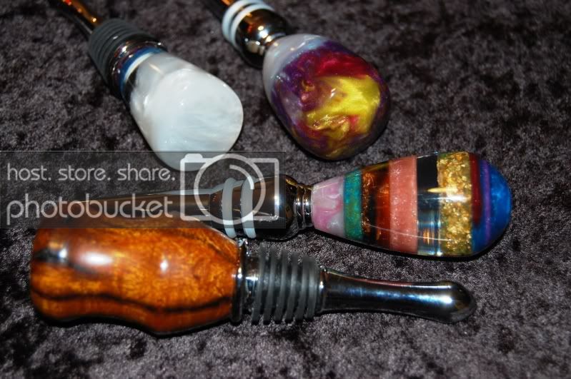

Jason_r & Live2Dive: Thanks for the links! It seems that they're using a horizontal mold while casting. I'm currently using a vertical mold I got from Brooks (Thanks again Brooks :D ). I understand that it's harder to control the swirls while using a vertical mold but I would still like to get the swirls. I assume that the main issue is my timing, temperature, pouring method, and whether or not the stars are perfectly aligned. :p I think I'll try a few single casts tonight playing with the set time (try to get to the old honey stage) and perhaps a few other things including the caster's equivalent to the rain dance.
Just out of curiosity, have you turned any of those? The ones you pictured don't look turned. What comes out of the mold is nothing like what's inside.
No I haven't turned any of them yet. I will be as soon as i can get some tubes to glue them to.
Yep. Technique and viscosity are probably the biggest factors.
With vertical molds, it's easier to get a "layered" look. If you want swirls that penetrate deeper and have finer lines, try pouring while it's a thinner, but also use a higher pour (just don't miss). The extra speed the resin gains while falling will produce finer lines (since your stream is smaller) and deeper swirls (since the faster moving stream will push deeper into the base color).
Then if you want to prevent color mixing, pre-heat the mold so it helps the resin kick off before the colors combine.

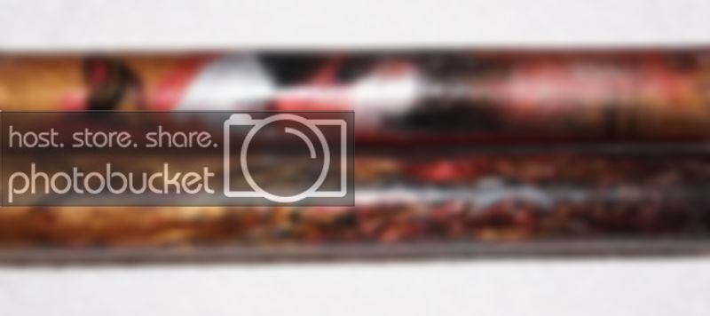

Here's a picture from a recent cast. Both blanks are from the same batch of PR. This one really stretched my abilities since I used 4 colors. I didn't get it perfect, but not nearly the worst I've done. And it will look different the further I turn it down.
EDIT: I should have told you that the bottom blank was turned just enough to show the inner swirls, and just lightly polished.
WOW that is exactly what I'm aiming to get.......any chance you can give me a few tips on how I can achieve something similar (with 2 colors though)??? :biggrin::biggrin::biggrin::biggrin::biggrin::biggrin::biggrin::biggrin:
Ok, I'll give you my super secret recipe. Bear in mind I've just poured about 2 gallons of PR total. 1 to 2 gallons is about the learning curve for the basics.
I don't heat my resin (although I might change that as the temps keep dropping). I also don't heat my mold, but I think from now on I will. I can't see a reason not to do that.
1. mix your mica.
2. I use anywhere from 4 to 5 drops per color. I don't use more for colors like green that take longer to cure, I just add the MEPK sooner to those colors.
3. Wait till one of the colors starts to harden. As you know already, that's where experience will be your best teacher. It's not an exact science for those of us without heated and cooled areas to mix & pour.
4. For swirls, use a stir rod. I use a thin wire with a few bends in it. I twist it going down, and continue twisting in the same direction on the way back up.
That's about it. There are tons of little things that different people do. But the thing that seems to hold true is that you will make mistakes no matter what you do.

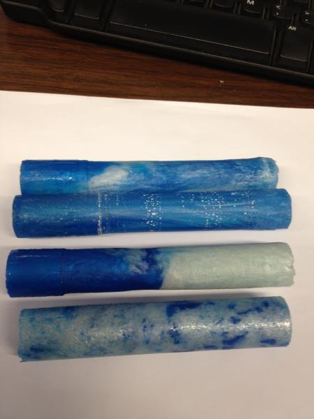

Here is an image of the blanks turned down. As Bsea said the 2nd from the bottom did have a nice swirl, it's just too bad I didn't do it all the way around the blank :/. One side has a swirl but the other is a crisp line. The blank above that one is one I poured last night but I was WAYYY too early on the pour.
I keep having issues with the timing.
Kinda dissapointed because I actually poured a glass of syrup to practice stiring so I could get the feel of the consistency that I should pour at:befuddled:
I assume that I'll need more practice on the timing but I did find that pouring the resin down a stick is a very good way to get a thin controlled pour of the PR.
2 things:
-Any additional advice on timing would be appreciated but I figure it'll just take more practice.
-How do you guys remove a small layer of the pr to get a look at the inside of the blank?
I used a skew chisel and a spindle gouge to remove a layer but I got a lot of chip outs and removed more material than I wanted.blank a little

One thing I've learned is that applying an external heat source will really get the swirls going (just don't use anything that may ignite the fumes).
Also, have you tried "inserting" your second resin with a syringe (or turkey baster)? May give you more control over how far down you get it...
I'm actually preheating the resin and mold before I pour and from there I put the mold directly into a makeshift oven (cardboard box with girlfriends hairdrier):tongue:. Over the last few casts I've seen the resin circulate in the mold while it cures...I'm thinking this could be a issue though if the resin is too thin because it'll eliminate any defined swirls and just mix the resin together....

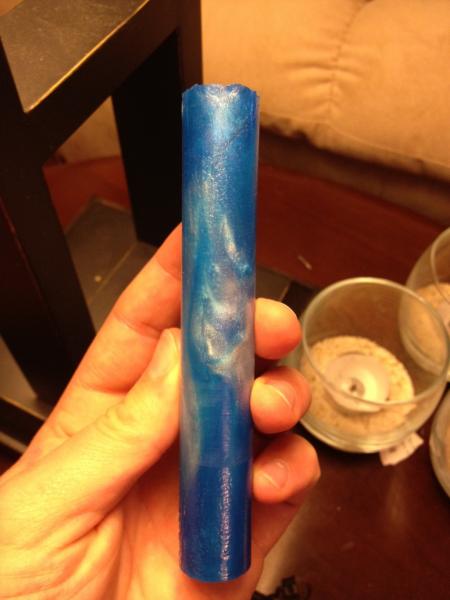

Here's a picture of my latest cast. I played with the amount of mica powder I added and achieved a semi transparent look where I'm able to see swirls within the blank :). As usual the camera doesn't do the blank the justice. lol. I'm going to try replicating the blank before I turn this one down :p. Have a feeling I may have gotten lucky but that remains to be seen.
