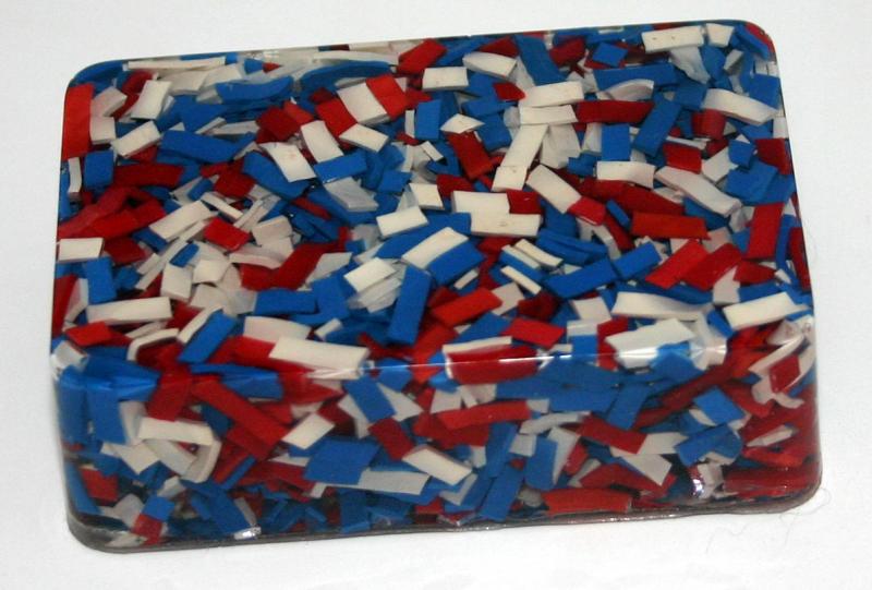

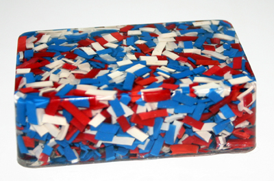

Also - attached are the pictures of my Rubber Band mold - it looked so good as a mold, but just can't turn - I was in the 4th of July spirit.

Maybe you can still take that idea and run with it, but as you found out the
rubber bands won't do it for you.
Try making up some small batches of resin in these colors and pouring
them onto a sheet of glass. You'll need plenty of white or powdered
pigments to make the resins opaque, but it should work. When the resin
cures, you can peel it off of the glass in a sheet (use a razor blade to lift)
and cut it into small pieces. Then cast it as you have done.
It wouldn't be as easy as using rubber bands, but should get you where
you want to go..

I don't understand "rubber band" mold". What I see a picture of looks like a big block of clear resin with tons of little strips of plastic embedded in it. Are those strips inside the pour rubber bands? If those strips are plastic, It should be turnable, but rubber, well that's gonna be tough to spin as it will not cut easy and want to stretch and pull on the chisel...or so my guess would be. You kinda lost me on what this is.
If you can't turn it with a chisel, you might try using some 36 or 50 grit sandpaper on hand sander to work it down to shape. I dunno, it might be impossible to keep the thin ends from lifting out even if you can shape it, or it might get dirty real easy, but I kinda think that the combination of softish rubber in the hard matrix might make an interesting kinda "easy grip pen"
Well - I still have a blank, I might give that a try :-)
