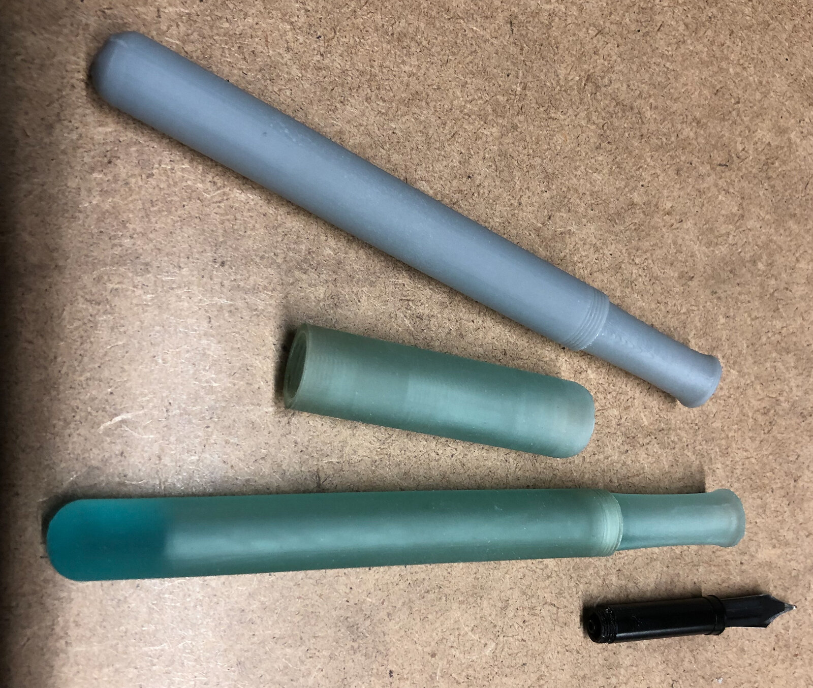

They may be useful for prototyping but the process is expensive, slow (unless you have thousands of $$$ to spend on an industrial unit) and the UV resins are toxic and smelly. I haven't tried to put one on the lathe, but the hardened material I have experience with is not as hard as an epoxy or urethane resin. I've tried prototyping fountain pen parts, and the wear characteristics, especially of threaded parts, are not favorable. Some of the translucent resins are attractive, but for the most part they are fairly ugly (nondescript gray). Resins are quite expensive also. Forget about using them for blank making - it would take at least 12-24 hours to print a single pen sized blank for most affordable resin printers, during which time obviously you could cast many conventional epoxy or urethane blanks for far less expense.
So, bottom line, if you have a few hundred dollars to spare and you love to tinker around with things that ultimately won't be particularly useful, go for it. I've made some cool little things on my resin printer, but nothing that is stunning or practical. I have gotten far more use out of my FDM printers, and for lathe work Alumilite casting is way easier, more durable and cheaper.

Just an update on resin printing: more engineering resins are becoming available on the market and some are almost affordable to hobbyists. Some have mechanical properties that look promising and some even stand up to tap and die threading (according to the marketing materials). I've got a couple on order to try. Here's a pic of a couple of ugly prototype pens. The translucent resin (despite the marketing hype) does not have durable thread properties (they turn chalky are wear quickly). The grey holds up better, and the section was able to be internally threaded using a tap for a Bock nib housing. One of the problems I'm trying to deal with is variable shrink rates during UV curing which makes tightly mated thread parts difficult to size and fit properly. On these pens the cap and body threads were designed into the print file and printed; the caps won't thread onto the body. I've readjusted the design files and experiments continue.....
