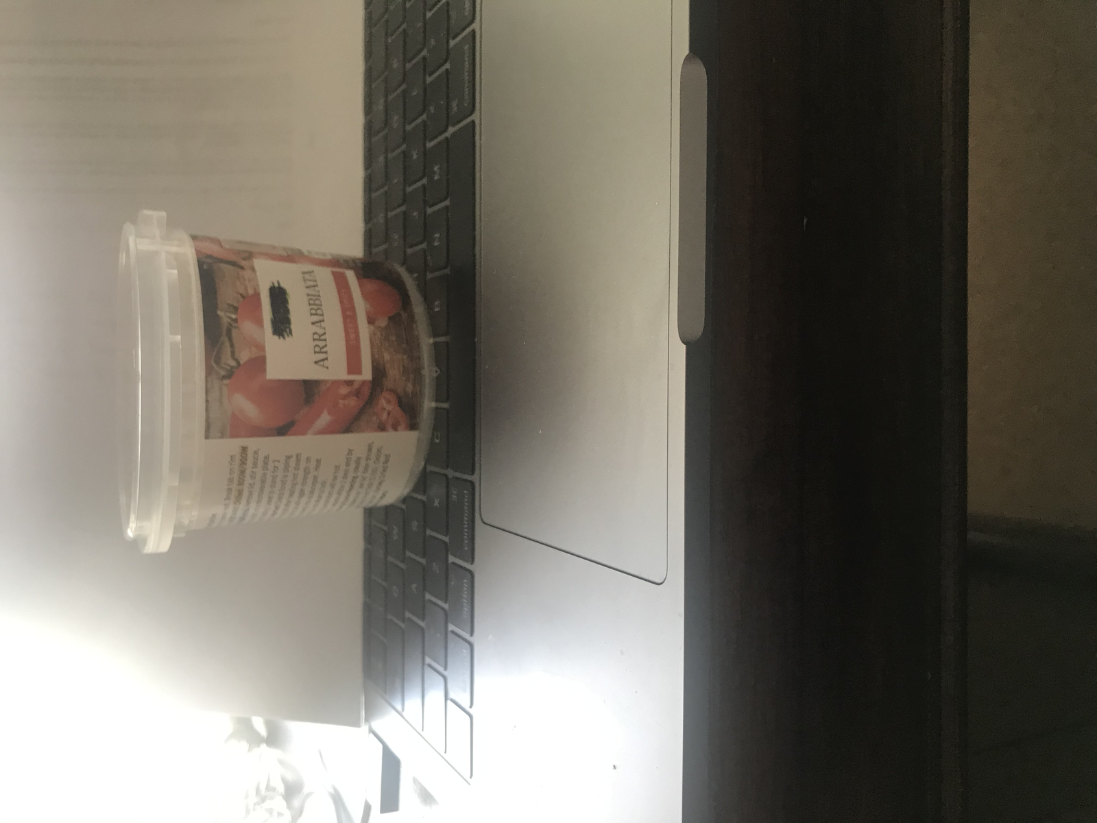

Have you tried the plastic tubs which contain pasta sauce --after a wash in the dishwasher of course?
FREE
They are only 3" tall with a wide neck for easy mixing, and hold more than enough for a number of castings
Mike
