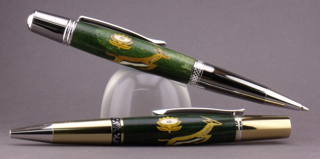

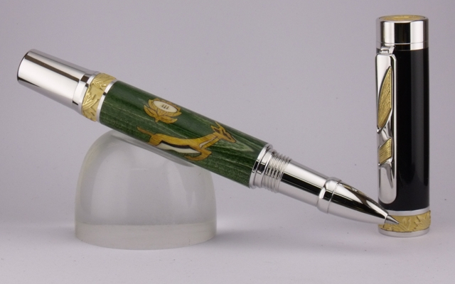

Here are three identical inlays ( South African Springbok Rugby themed )
One on a Sierra, one on an Elegant Beauty ( sleeved ) and one on an Imperial ( drilled )
I think I put one on a Jr too, but can't find a pic.
I reckon you could make them fit just about any pen.......well....maybe not a skinny slimline..:rolleyes::biggrin:

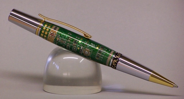

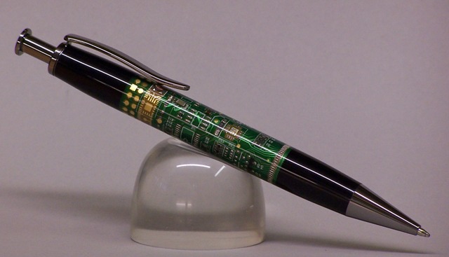

....oh, and you can also do the same with the Sierra Printed Circuit Board ( PCB ) cast tubes. Or any other Sierra cast tube.:biggrin:
Here are two. One on an Elegant Beauty ( sleeved ) and one with 'Ooops-bands' made to fit on a LauLau Long Clicker.
So....now you don't have to use those expensive blanks on a crap kit !!:biggrin:
