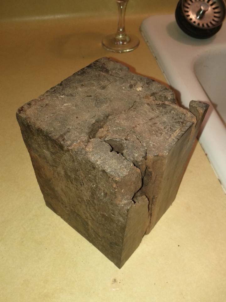

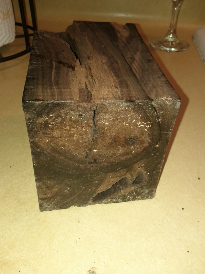

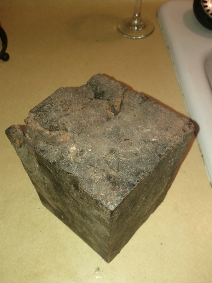

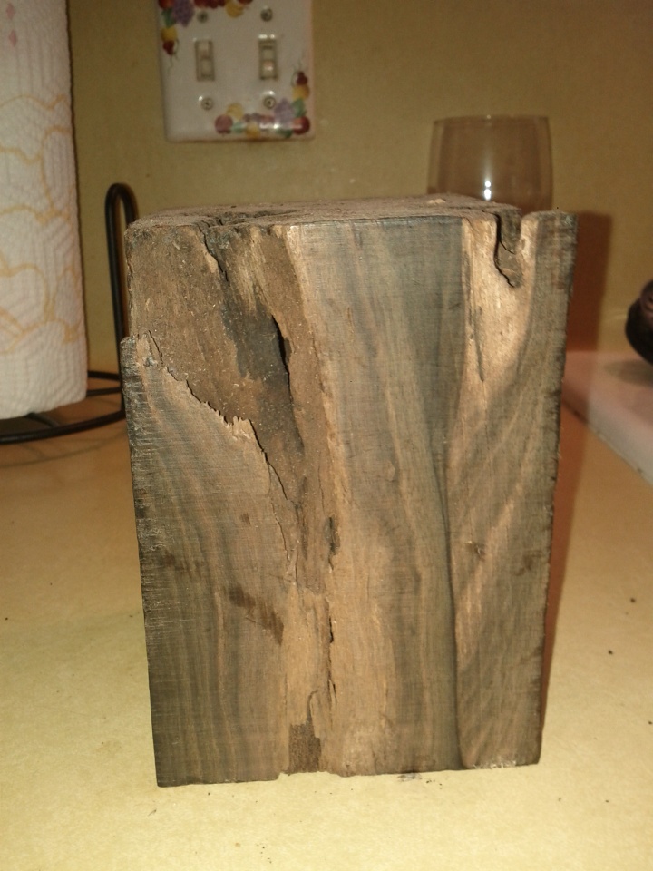

Here is the piece in question. I tried the baking method, didn't get all of it out. Seemed to melt most of it and evaporate it. There's still some left. So, on to the next method!
Side note: Looking at the side view of the color and grain work, seems like it might be Walnut?
