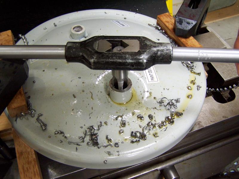

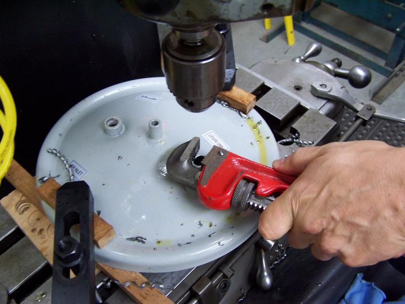

Just drill, thread and plug if you don't want to restore it to original condition someday. You can re thread to any thread you desire easily enough, or even just put a bolt with a gasket through the hole and tighten with a nut on the other side.
I drilled it to be super thin, then broke it with the pipe wrench. Then retapped it.
But I guess it would have been easier to use a torch.
