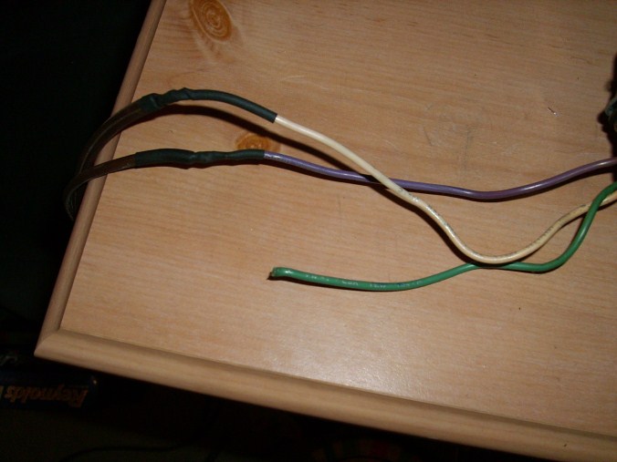

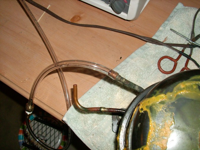

Here is a picture of mine, minus the tank I haven't received yet.
Here ya go Tim...I really need to be more responsible about pic's:redface::frown:
First...this came wired from the guy down the street so I can't offer any "this that or what". The white...I think it's neutral?? is connected to two wires off the 3 prong plug and you can go from there. Green as you can see is just hangin' in the breeze.

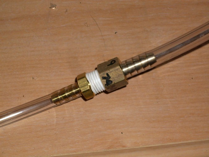

I tossed in a pic of the connector for the vac plumbling...just a connector to go from 3/16" tubing (on the chamber side) to 3/8" tubing (my pump size). It really doesn't get any easier!! Hope that helps and if there is anything else I can do to help...just ask!!

Jim, I can't see the entire wiring set-up from your pictures. I just want to know if I can wire up the outlet plug directly to the 3 wires coming from my pumps. The 3 wires coming from my pumps are connected to a box (starter?). Then the 3 wires from the outlet plug are connected to the box. The starter boxes are tripping the pump off.
I just want to know if the refrig pump can be connected directly to the outlet plug, without going through the starter box.
Does your pump have some kind of connector box (starter)? Or is it connected directly to your outlet plug? (I am guessing that the starter box is necessary and I don't know how to keep the pumps running until I switch them off.)

You always want a a switch on the hot lead (wire), and you certainly want the ground lead connected directly to the plug ftom the pump.
The switch system on the pump has a pressure switch set to open at 15inches of vacuum. Replace that with a straight switch and a fuse.

I'll pull the cover off and get a shot of that too. Mine is wired directly from the wires coming from starter box to a 3 prong plug.
Thanks anyway Jim. I think I have the jist of it. I'll have to figure it out myself. If yours has a box on it then you have the same thing I have. I'll just check the voltages and go from there.
And thanks Ken V. I now have a starting point and I think I can figure it out.
