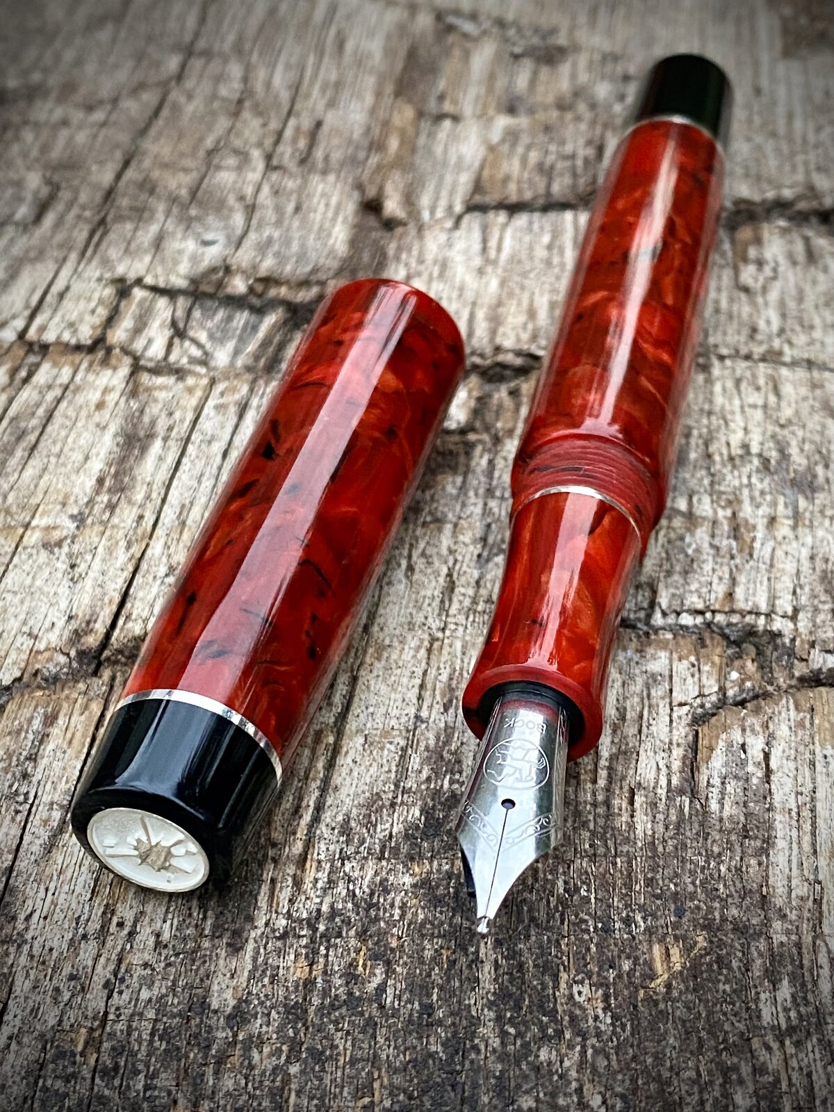

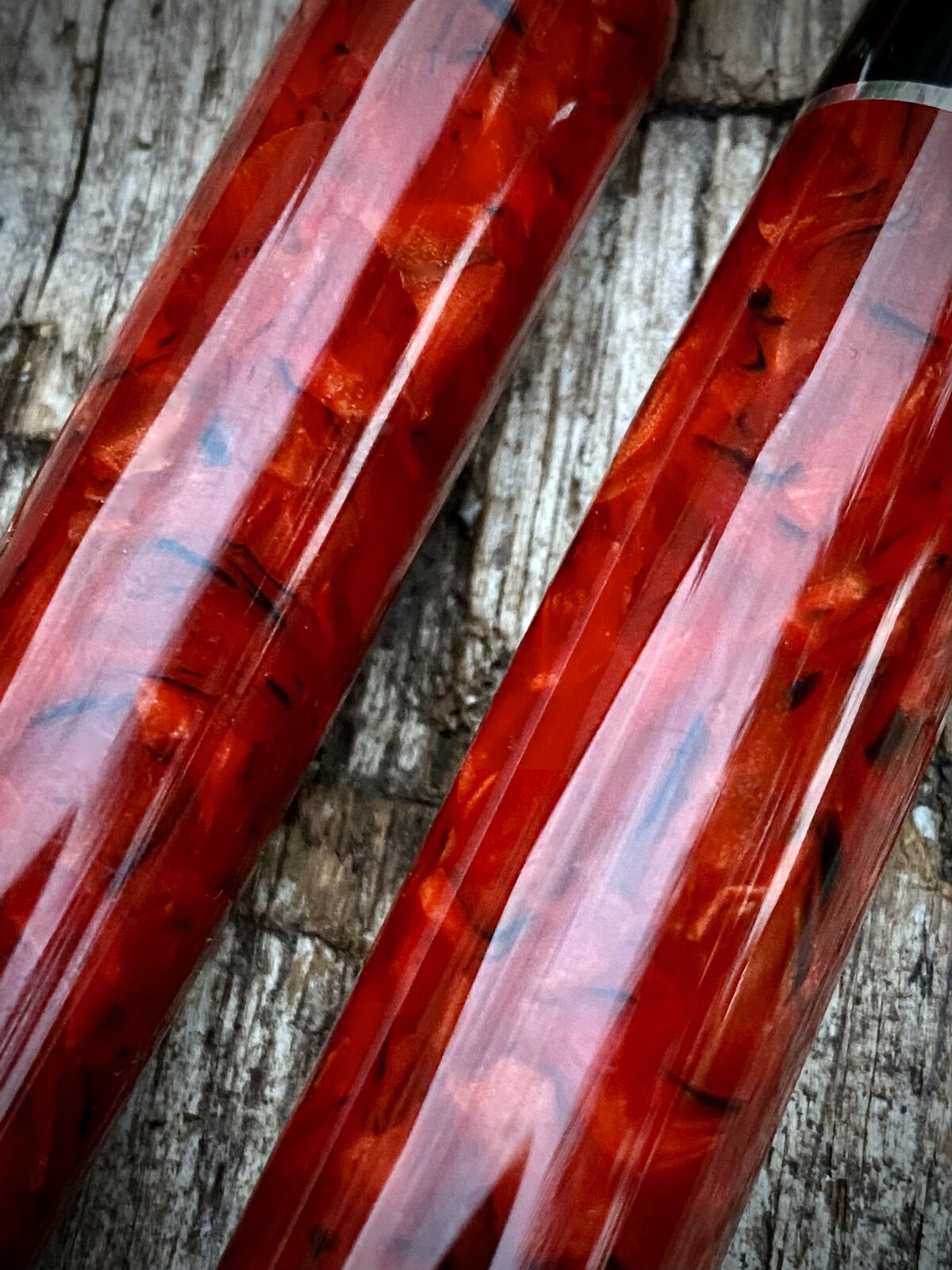

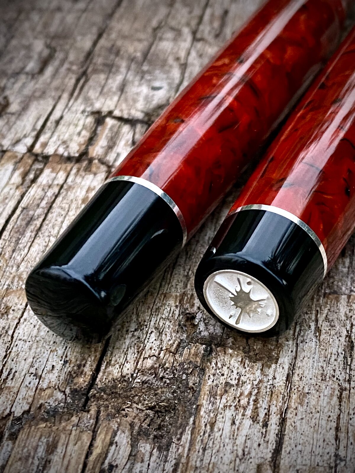

I have had this red Mazzucchelli cellulose acetate in my "Special Blanks" drawer for a while and kept picking it up and then putting it down as it never really appealed. It appeareds more toward the orange end of the red spectrum. However I decided to make it on the weekend and ended up being really pleasantly surprised by it. The colour of the finished pen is a much deeper red than I had anticipated.
Its a shame that this stuff isn't made any more, but I guess the scarcity adds to its appeal too.

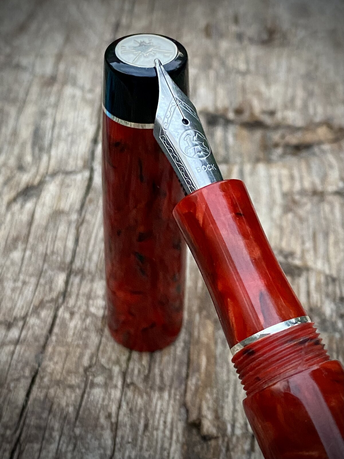

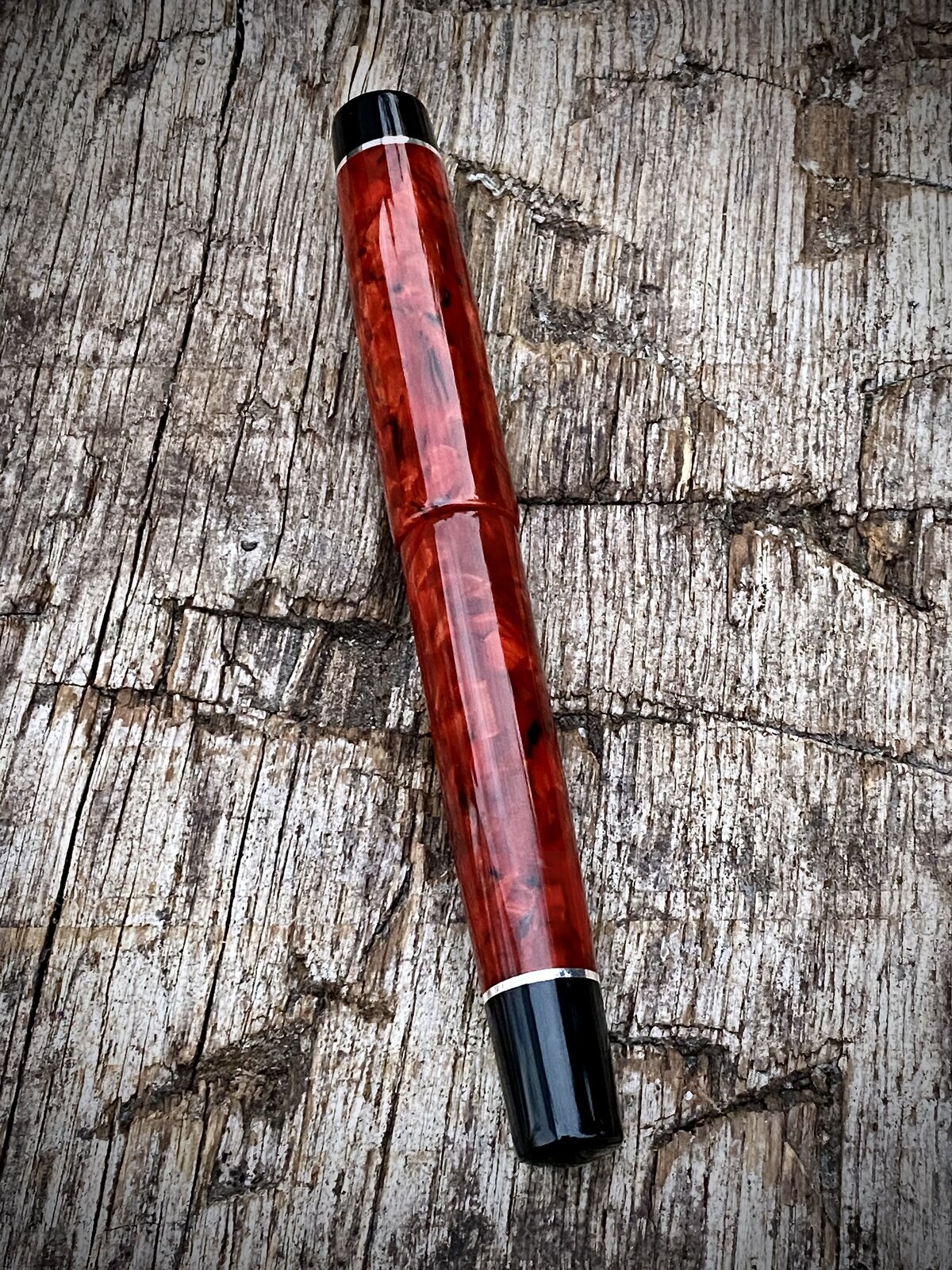

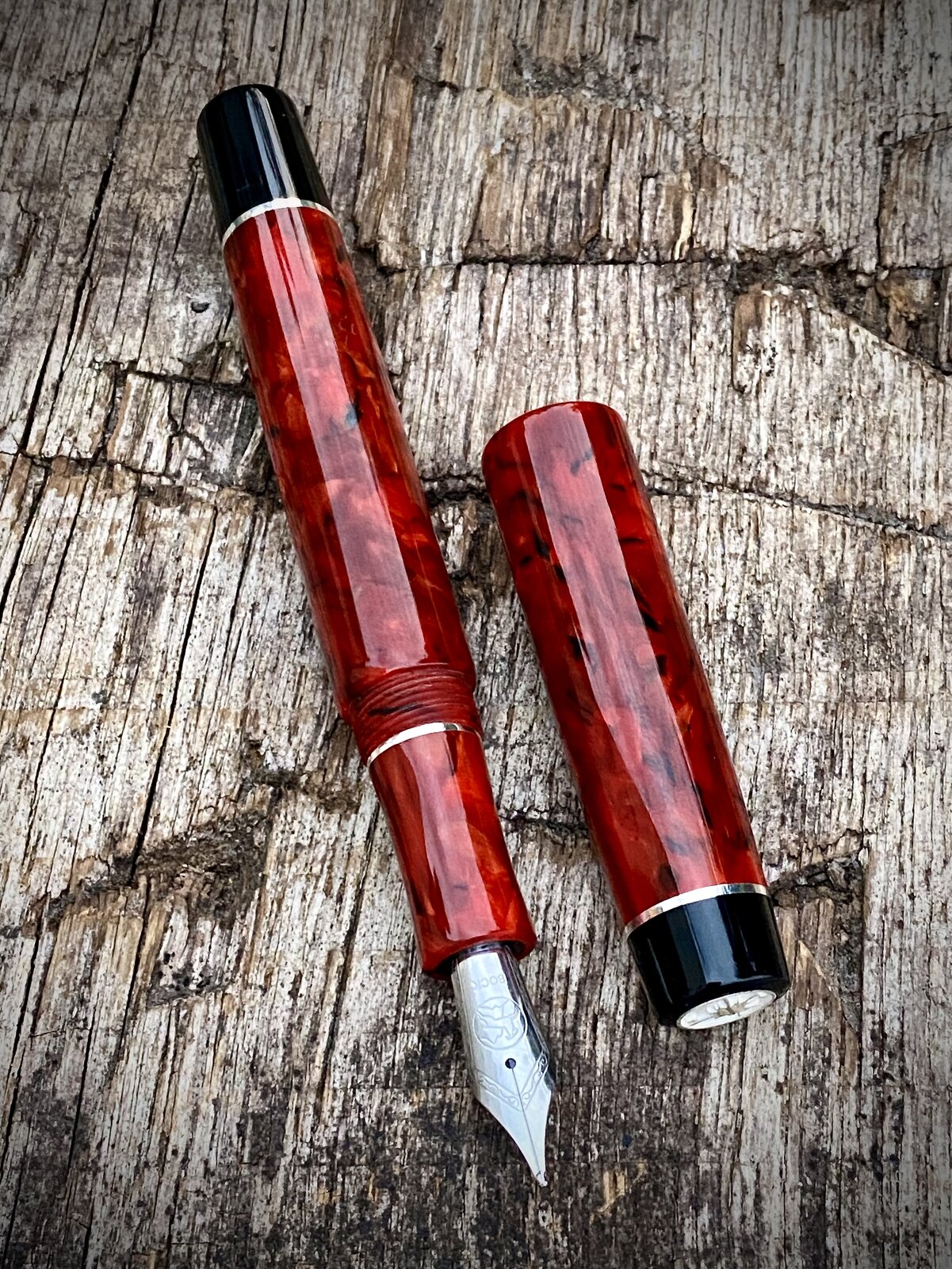

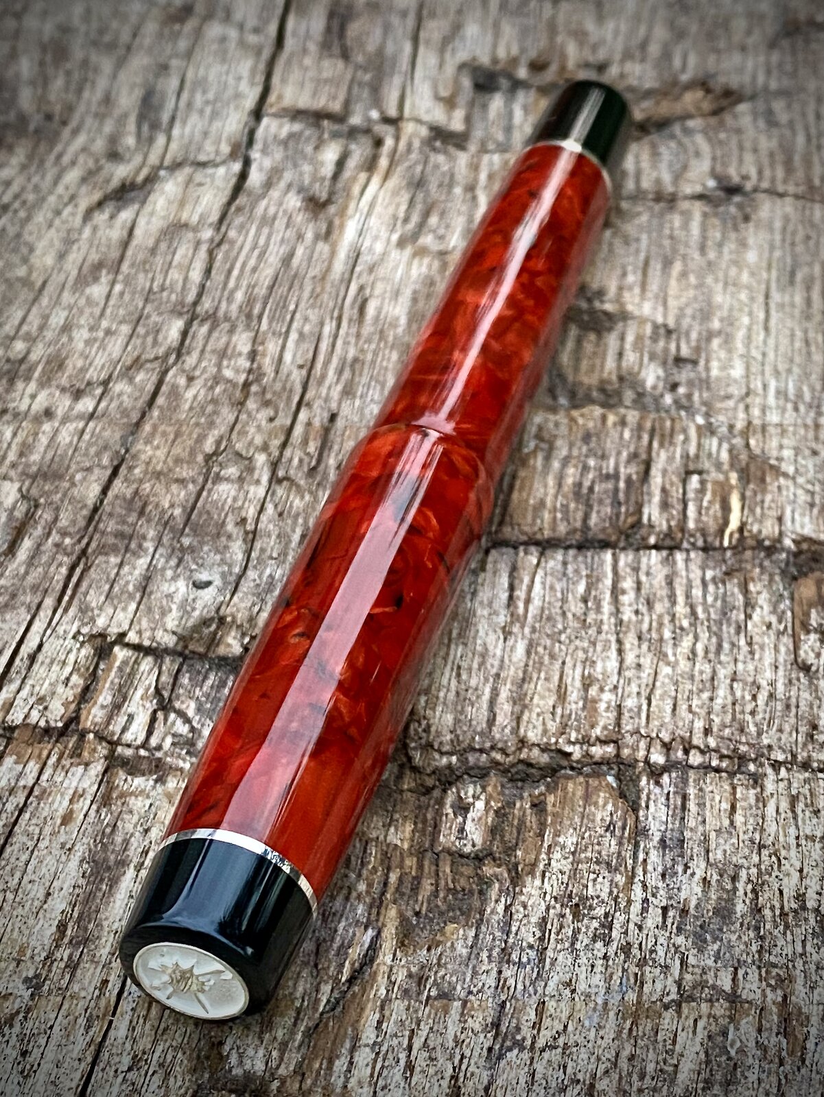

The pen has 13mm triple lead threads and sterling silver accents that are cut from sheet using a jewellers saw. The coin is cast by a company based on my own design. Nib is a Bock and it is fed by c/c. The black finials are made from acrylic.
The pen, when closed, is around 144mm and open it's about 133mm.
I am happy to receive feedback, both positive and "constructive" . I will not be offended at all.
