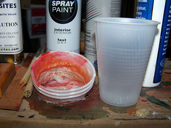

These are a "6":
Thanks for this pic. I've been using Alumilite and and am going to try casting with Polyester resin. I just checked the cups I've been using with Alumilite and they are the same #6 in the pic. That would have been a messy mistake.
