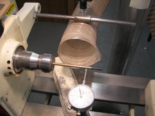

Since you use a 3 jaw chuck you won't ever be perfect but here's a little tip. I have a dial indicator mounted on a post that fits in the banjo (tool rest holder). I put it on the end of the mandrel just before the threads and rotate it by hand. When I get to the high spot I tap gently with a plastic head hammer. 3 or 4 tries and I can get the runout to under .001". You can make your own post out of anything and an indicator can be had for under $20.
Hope this helps!:wink:
I found a photo.......
