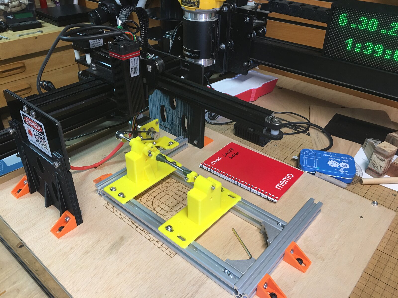

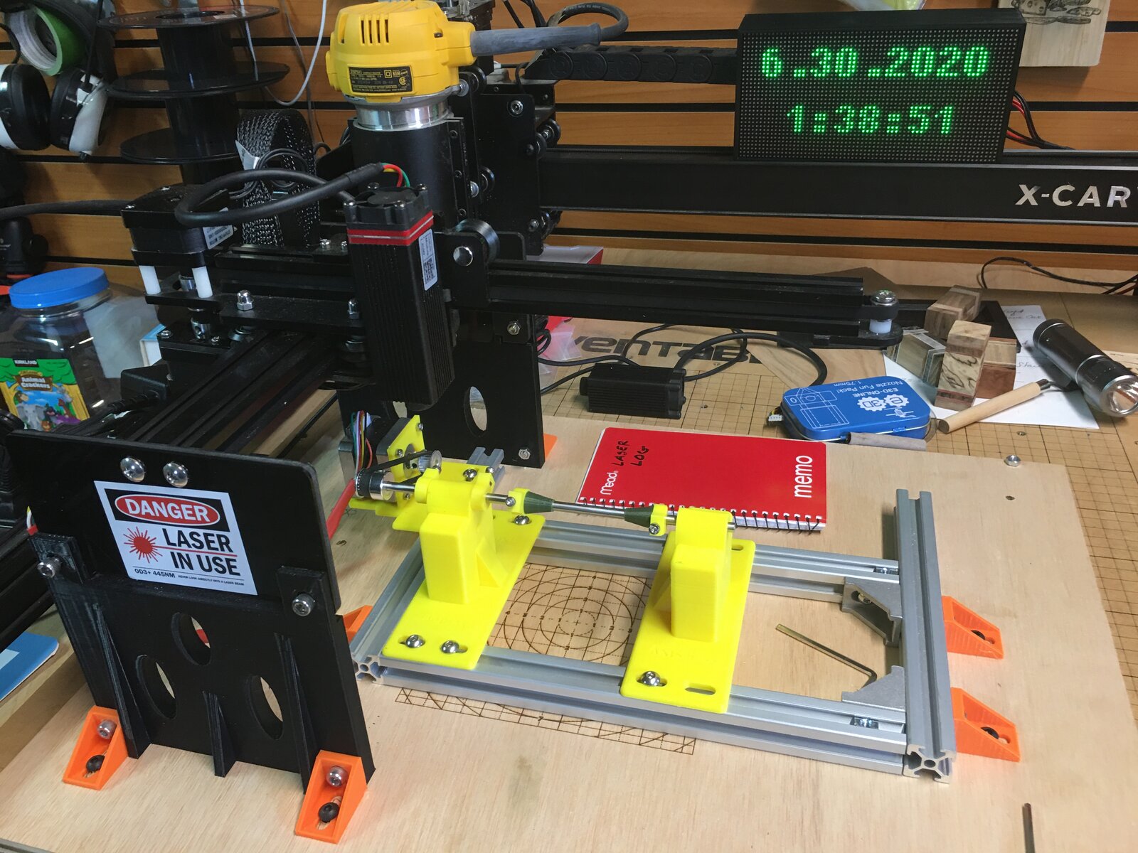

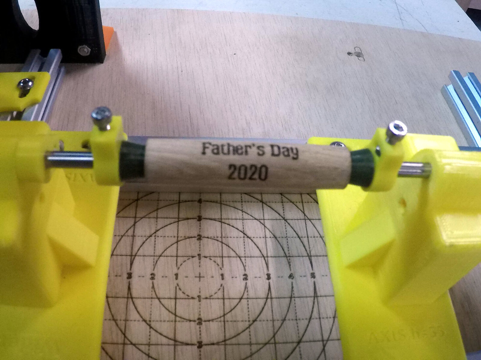

So mybe not what you are looking for but I took a basic NEJE 20w Laser and 3D printed the parts to make my own rotary jig back when very few if any reasonably priced systems were available. Not pretty but it has been getting the job done for over 4 years and several hundred pens.
I should also add that this setup is totally dedicated to engraving pens. While there a several good rotary jigs now most are geared tolarger objects like tumblers and glasses.
