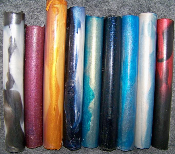

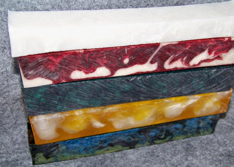

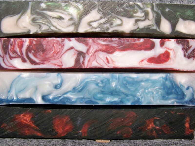

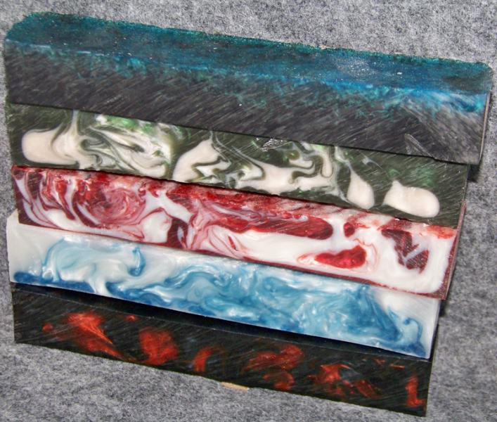

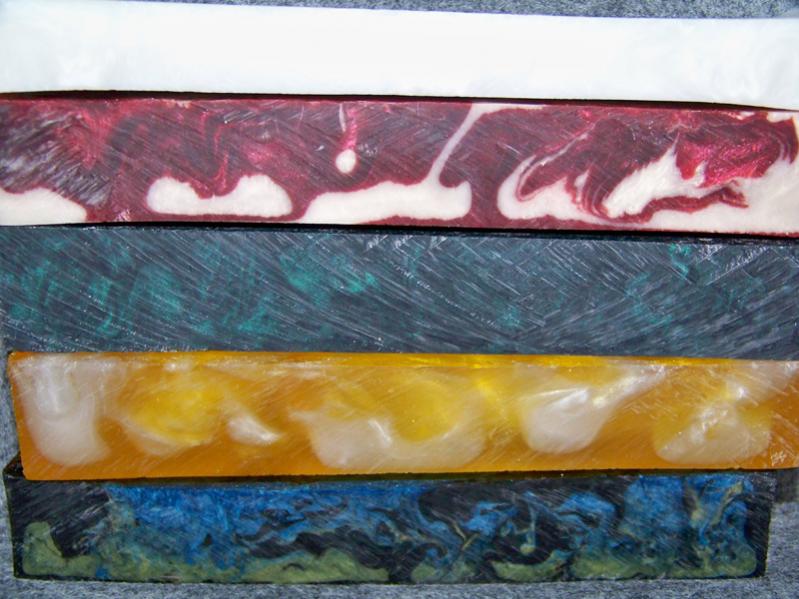

Been trying out some new colors and swirls. A friend of mine gave me some plastic tubing to see if they would make decent molds, they work fine but are only good for one casting. I end up having to cut off the tubes after curing. However I actually like the swirls I get in the tubes more than in my rectangle molds. Reason is I like how the colors flow down the tube and kinda streak instead of the big swirls I usually do. Maybe I'll try to make a vertical rectangle mold and see how that works :confused:. A color breakdown would take forever to type so if there are any questions don't hesitate to ask. Thanks for looking and also for any comments made!

Love the swirls.
I've done this. My hot tip is: slice the tube off with a sharp knife rather than a saw and then just put a bit of electrical tape over the slit. Next time you need to use thq mould, the slit will already be there. I've done this with PVC electrical conduit and it saves a phenomenal amount of resin if you cast round.
Here's another trick I suggest: If you have several thicknesses of tube, cast a thin one, then drop that casting into a bigger tube (at an angle) and set it in a different colour. Repeat with another larger tube. When you turn it you get a really cool interface between the colours.
Love the swirls.
How is that not any wasting? You only need a thin layer for the final cover over the tube, also, your main thin smaller diameter cast is already set in colors and the newer one is just going to cover it.

Ok ok, you broke my arm, if you really must you can send me the red and white one in the 4th pic. :)
I do have those and several others up for sale in the classified add if you are really interested. The one's you pointed out are #48.49.50 here: http://www.penturners.org/forum/showthread.php?t=65210
