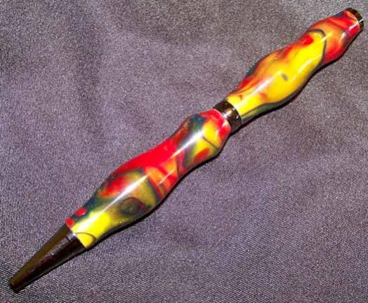

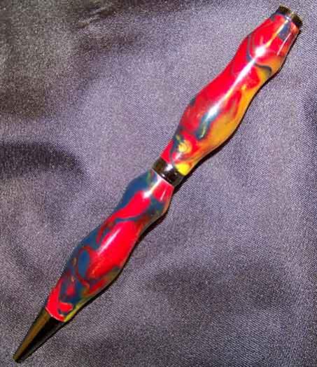

When I did my first home cast I used Testor's Enamel paint instead of their acrylic. I'd use the metallic colors over any of the others for a really nice sheen. Just remember to wait for the PR to start to gel before you mix it in your mold. Keep a close eye on it after adding your hardener bc it can set up on you before you realize. I also switched to used mica powders I order from this site: http://www.coastalscents.com/cfwebstore/index.cfm?fuseaction=category.display&category_id=35 Here's an example of the enamel paint I used and how it may turn out for you:
