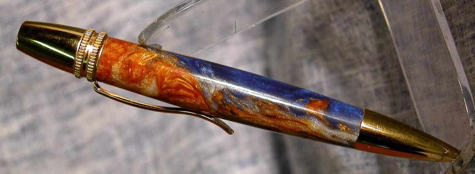

I was following a thread awhile back discussing the virtues of RAW vs. TIF format, OK heres what I get with an old Nikon Coolpix 5700, about 5 years old with RAW I only get an image file that is 7.65 MB but doesn't match the RGB workspace, it reads as Adobe RGB 1998 with 25608 x 1920 pixels
However when I process as Tif the file size is 14.1 MB nearly twice the size, But if I open the file in Photoshop CS as RAW all of the tweaking tool are open as well, including the light temperature, which means I don't have to go to Image-Adjustments and then each correction that I need because I have a crappy lighting set up, Actually hardly any, just 1 Halogen work light and a small incandescent work light about 18 inches over my pen, sidelighting with the Halogen at about 45 degrees from the right front.
This was shot RAW
This on was Tif
But gosh darned if you have to upload for internet,that means changing to JPEG and you wind up with a file that is whacked from 14.1 MB to 82.5 KB or else make someone wait 30 minutes for an image to open,
How bad does this background interfere with the pen, I shot a new pen and it’s on show off your pens,it uses a better background I think, criticize at will please, constructive suggestions also gladly encouraged, I’m trying to figure out how to do the most with what I have, Santa ain’t gonna help this year, [xx(][B)]
