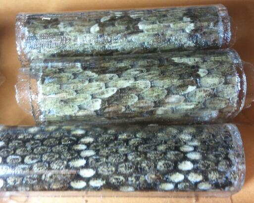

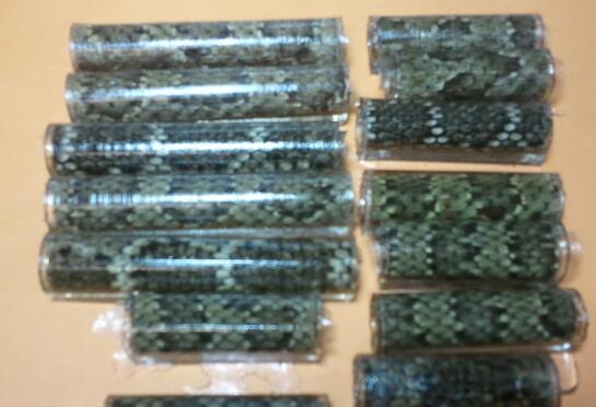

Used the rainy day to get some snake blanks made. No vacuum. No pressure.
Just the ultrasonic cleaner and toater oven.

Thanks Jeff. They are a lot of work to make and lots of material lost when they go south. I'm not sure what I hate loosing most...the time or material.

They look great Don. It's a lot of work making snake skins. I have managed a 100% failure rate every time I tried! Think that's the wrong road for me. ;)

But then it takes more time to earn $$$ to replace the materials...my failure rate is quite low after 10+ years perfecting the process I use.

Toater ovens are hard to find...they have been out of production for several years. But, I understand a toaster oven works just as well.:biggrin: I need to learn to "swipe" a little better and check the spelling before posting.

toater oven or no toater oven. them is some purty blanks.

Unfortunately I'm just perfect for Saturday....I still have my occassional "into the trash" session. But, casting is much better than before I started using your resin savers and Fred's molds. Both have helped tremendously.
Hey! We're in a two way tie with a perfect record!! :biggrin:
I just seem to have trouble with skins. There's always one bubble
somewhere.. some portion that I didn't look over quite carefully enough.
Or I use the wrong paint on the tube :redface:
Yes...the ultrasonic cleaner vibrates the water and in turn the resin inside the container it is in. The air in solution is released much the same way the gas in carbonated drinks is released if the drink is aggitated. The cleaner I use has a heat function which thins the resin allowing the air to more easily escape.

Don--
Do you use the sonic cleaner to force the bubbles out of suspension?
