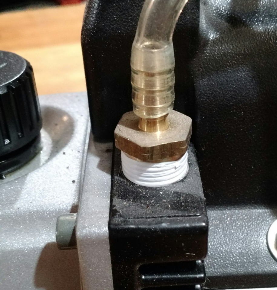

Thanks Brian, exactly what I'm looking for. Did it come with all you need to connect tubing to?

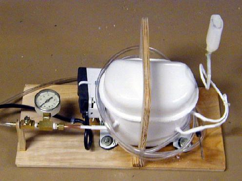

I don't have personal experience but builders doing fiberglass, Kevlar and carbon fiber epoxy layups for rockets, models, molds and especially composite aircraft very often use a "cheap little sucker" (aka refrigerator compressor) for vacuum bagging. As you know refrigerators are quite quiet.
Here's one write up - James Bodnar's Vacuum System
Here's a link to the original writeup - The Cheap Little Sucker
