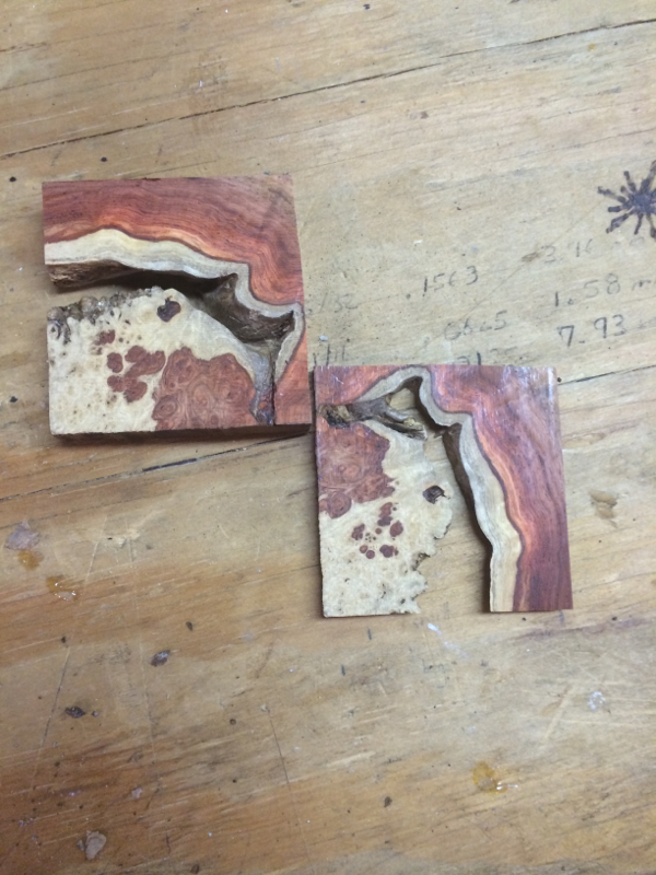

Does anyone have a a good tip me this for a quick and cheap mold for casting?
In this particular instance I have two pieces that I want to cast into the gap.
I don't have any plans to do these on a regular basis so don't want to spend the time on a cutting board mold.
Maybe a disposible Tupperware type container?
Any ideas?

Pendants is the idea.
I'm thinking of trying one clear and one with some color. I've not yet been inspired on what color would look good though. Ideas welcome.
Looking at your pieces, this would be my suggestion Dan. I wood bookmatch the two pieces to make a very interesting pattern. next you could add a boarder top and bottom to make your final size. If you follow this path, there is a two part system called Envirotex that you pour over the surface to create a glass like finish. Idea 2, make a pine frame the size you want and line it with a piece of Seran Wrap to keep your casting materal from sticking to the wood. Spray the mold with Pan or any other non-stick spray. You could band or scroll saw your frame in any shape you want. I would first fill my mold with about 1/8 inch of casting material, let cure, place my pieces face down in the mold, and add the rest of your casting material. That way you will have a smooth surface on the front of your project. Jim S
P.S. I see you are making pendents, so these pieces most be small. Use plactic cups to make round pendents, only place them fase up when pouring. Modeling clay can be used to make freeform molds, just spray with Pam before pouring. The tin foil is good if you want to have an uneven edge. Jim s

Also i would make a river out of those. some blue color would look nice. turquise pearl ex would be perfect.

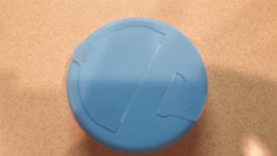

another Idea

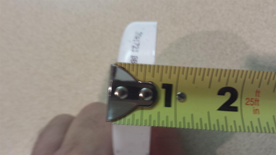

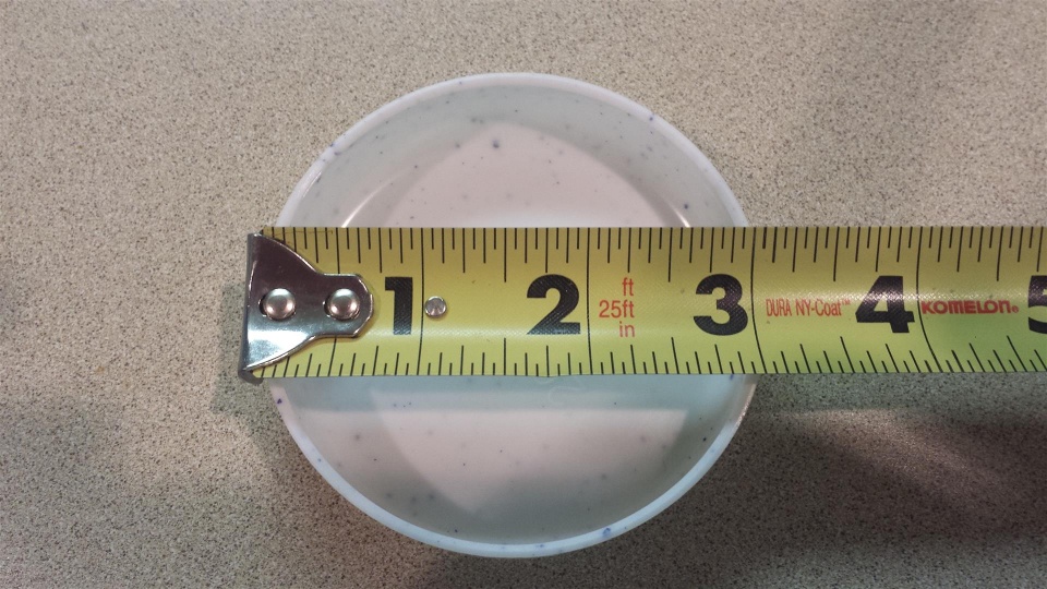

The following is a plastic package that mints come in. After removing the blue top (just snaps off) I took pictures of the dimensions of the white plastic base. You would probably have to use some sort of mold release, but it might work. sorry for the crappy phone pics.

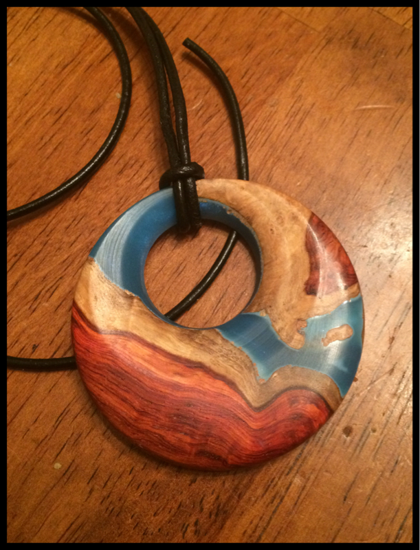

Here's what I did.

A very pretty pendant you've made mate, the colour goes well with the wood colours.
There is also, a little details that I would like to share with you, do you see those light coloured edges on the resin and wood joint...??? You may not know but, there is "separation" in there, the resin is not stuck to the wood...!
There are some other causes that can make that happen in certain woods, vibrations are one culprit but, specifically with oily woods such as the wood you used, unless the natural oils are dealt with, you get the edge separation and in many cases, full separation altogether, as the resin did not adhere to the wood, as you may think...!
There are 2 "cures" for this, the best one is to neutralise the surface natural oils of the wood, I mean "surface", as most cases the wood will still maintain some oil at its centre, particularly with thicker wood than the ones you have cast, with those, the oils will be gone by, roasting the wood in an oven @ 70° celsius for a few hours. If the heat elements are expose and you want to make sure the wood wouldn't burt, wrap the wood in foil paper and use 80° celsius to make sure the oils are crystallized and therefore become a solid part of the wood, that way, the resin will adhere to the wood surface as good as any other non oily woods...!
The second option is to use the super thin CA to soak each joint of the resin/wood piece. You do this before you start working on it and if required, halfway to the finish product. In this case, and with the wood surface having some oil preventing the resin to stick well, there will be a small gap in between to 2 material, you want see it but, you will see the thin CA going in and darken the light colour resin on the edges, making the colour look even all the way through.
The thin CA is able to create a bond in between the 2 materials, CA chemical components do neutralise the wood oils in small quantities/amounts, an oily wood can maintain most of its natural oils inside, the important thing is to neutralise the surface oils if you want to have it to adhere with something else...!
The "roasting" of the oily woods, is one of the reasons why, I have successfully cast and stabilized many blanks that others have had so many troubles with, it may take a little more time in preparation but the results are well worth it...!
