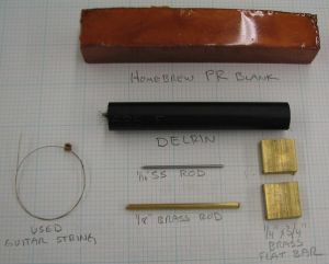

Its actually a very good material for making protoypes and even kitless pens. Machines and threads as good or better than any material I've worked with. Doesn't adhere well with glue, but why use a tube when you don't have to.

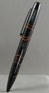

Here are a couple I made using acetal (Delrin).
The first one is COMPLETELY kitless and all the black parts are acetal.

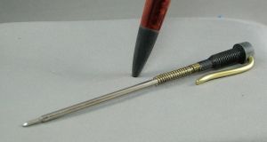

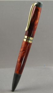

The second one uses a tube, transmission and a clip but is still considered kitless. On it the nib and finial are acetal.
