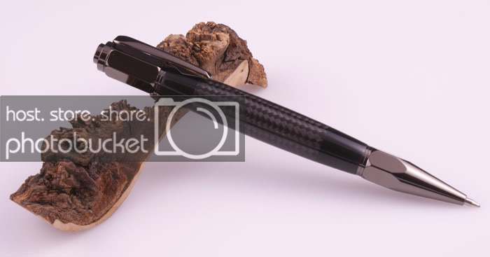

This is a pen I made using carbon fiber clear PR and on a vacuum for 3 minutes although I lost some resin due to the fact that I filled the molds to the top not thinking that it would troth up like it did but luckily I had a little degassed resin left in the container to top the mold up.
So very happy with the result because of no bubbles so yes maybe some bigger molds.
