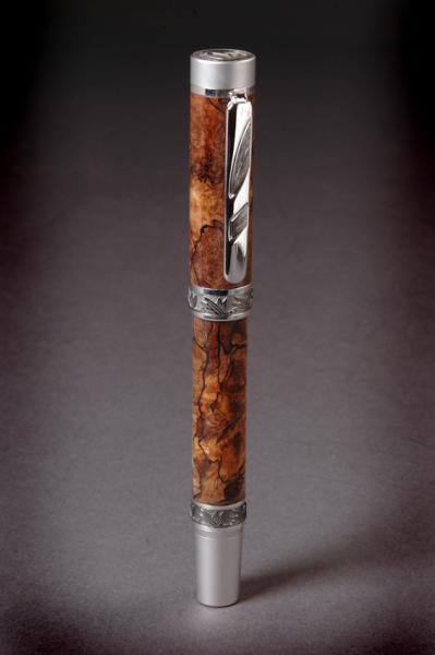

I started using Resinol about 2 months ago. So far, It appears to work quite well. I've had several blocks of spalted maple on my shelves for 10+ years that was so soft it could be picked apart with your thumbnail. After a Resinol pressure treatment and a 2 hour bake in the oven, the maple is hard and consistent in density. This maple was some of the worst, punky maple that I've come across. I used this maple for some small turnings that I tried to stabilize with CA, Minwax, and a few other products, but always met with mediocre results. The blanks were 7/8 in and the 90C appears to have had complete penetration. I've processed Black and Red Palm, Spalted Cherry Burl, Maidou Burl, Spalted Afzelia Burl and Spalted Madrone with great results.....So Far!
Here is a pic of the of an Imperial FP made from the first batch of the above mentioned Spalted Maple.

How much pressure did you put on it? How hard did it make the Maple? How did it take a finish?

The maple was under 80lbs of pressure for 48hrs....I had it in a batch with some other blanks that were not as punky and I wanted to make sure that I got total penetration. This Maple was soft enough that I could have put it under pressure for only 24 hours.
After the oven cure for 2 hours at 225-250 degrees, the maple was hard enough that you make only a slight mark with your thumbnail (if you really tried).....The before and after is remarkable.....I'll get a pic of the before and after test blanks. This Spalted Maple was so bad that my first thought was that it may be unusable.....so it sat on a shelf for all those years. I knew eventually there would be some way to save this beautiful spalt. The test blanks that I treated, polished like glass and I knew that I had something that I could work with. I'm happy to report that the Resinol treated spalt sanded quite evenly on the lathe (considering the original condition of the wood)

The pen in the photo was finished with thin CA and was very easy to apply.
The Resinol does not appear to seriously change the color of the wood. The Cherry Burl that I treated did not darken.

thewishman.....Yes, It is gorgeous maple and thank you for the kind words.
