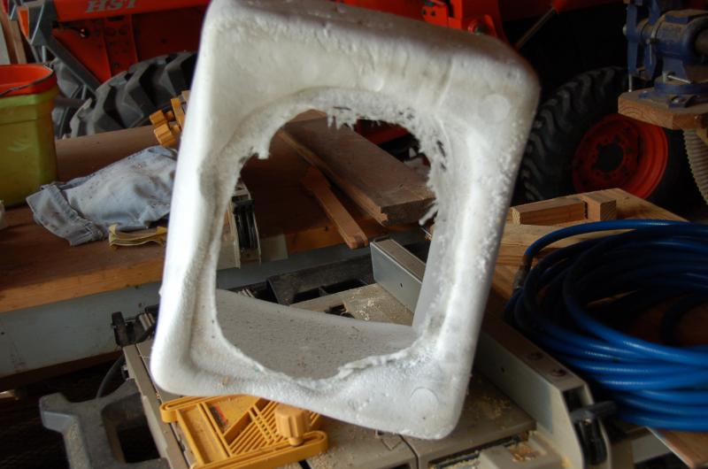

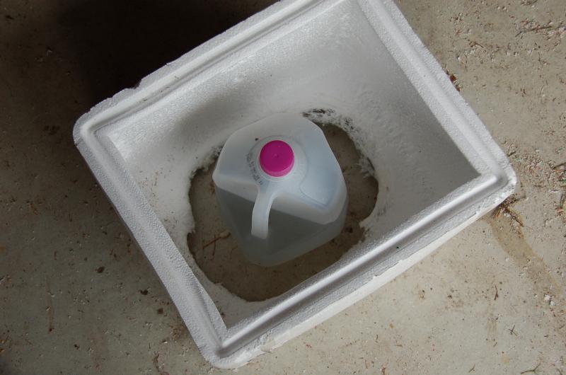

The standard milk jugs will not leak, but you can still smell the fumes real strong. Look what it did to a Styrofoam cooler. Just the fumes did this to the cooler. I have COPD. You can imagine what I went through until I figured it out.:eek:
If you have COPD, why the heck are you working with something like PR? No offense intended.
