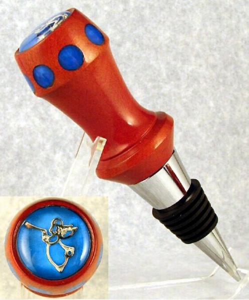

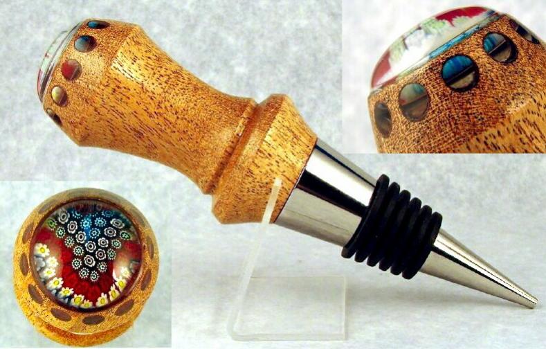

Here are some wood stoppers that have been embellished with resin, cast into drilled holes, similar to what you're asking about...

Ed do you have a tutorial anywhere or if you will answer a question, can you give me a little insight how you did the blue one??? Where the holes on the side drilled first and then you poured the resin in and it filled both the top and holes while being supported in a mold. I want to do something on those lines to a pen body. Thanks. Will check the archieves.

I don't have a tutorial on this process, but I should add that to my list of to-do's. It's really pretty simple:
1) Turn the part to the rough dimensions of the finished piece, plus about 1/32" for later finishing.
2) Using a Oneway Drill Wizard and your lathe's indexing feature, precisely drill a series of holes around the piece.
3) In the case of a bottle stopper, drill another hole in the top of the stopper using a drill-chuck in your tailstock. Here's the rub…for a pen, you'll need an access hole to pour the resin into.
4) Remove the piece from the lathe and wrap the newly drilled side-holes with masking tape.
5) Using the access hole on top of the stopper, fill the cavity with resin.
6) After curing, remove the masking tape, re-mount the piece on your lathe and finish the part.
For a pen-specific hole filling/embellishment tutorial, dial in to this photo how-to I made several years ago.
